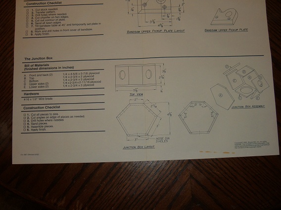

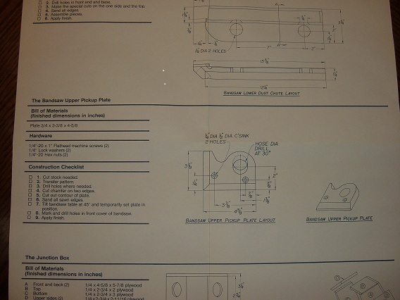

[ATTACH][ATTACH]11740[/ATTACH][/ATTACH]Here are the other 2 pics of the dust collector plans. Hope they will be of help to someone.
dust collector plan #2.jpg (75.52 KiB) Viewed 3500 times
dust collector plan #3.jpg (74.31 KiB) Viewed 3596 times

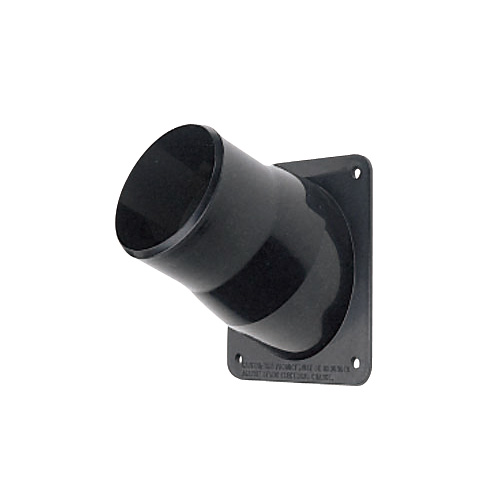

Rockler sells a universal dust collector port for 7 bucks
I added one to my old Craftsman table saw, and it works fine with my shop vac.
I would think it would be easy to add to the bandsaw (mine already has a shopsmith elbow port on it, which also works well with the shop vac)
you can order one here [http://www.rockler.com/product.cfm?page=16967&rrt=1] or just visit a Rockler store.
