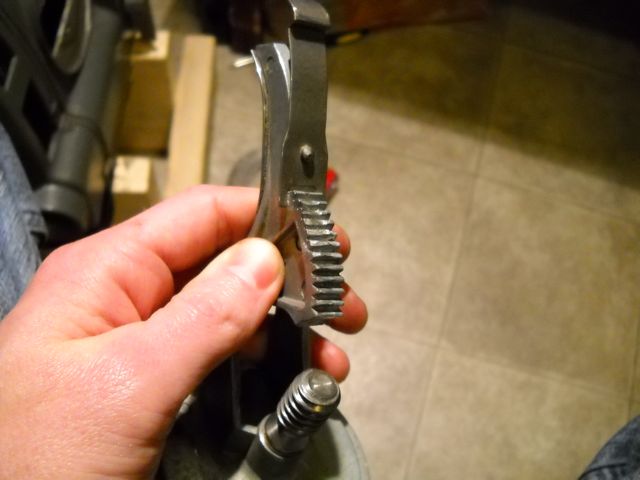

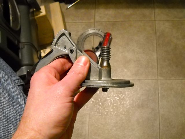

As requested, here are a couple pictures of the quadrant & worm:
As you can see from the first picture, the teeth on the quadrant are quite worn. When I have the speed control off the headstock, I can get the worm to move the quadrant arm through the whole range, but only by carefully adjusting the positioning. When I put the speed control back on, the worm is unable to adjust the quadrant arm out of the fastest speed setting.
In the second image, if you look carefully, you can see a little daylight under one side of the worm gear (between the worm and the brass ring underneath it). That is the only real indication that it is not quite straight. There is a little wearing on the worm at the top and at the bottom. I wasn't able to get the camera to show that real well.

Does the far end(top in your 2nd pix) wobble when shaft is turned? If it doesn't wobble,(out of round/true) then it does not need replacing.
The quadrant does indeed look beyond hope!:( Judicious filing to reform the teeth MAY help!

Wow! It's like someone took a hammer to one end of the quadrant rack!
I'm inclined to agree with JPG on reforming the teeth. If you have a needle file, that might get you by for a while. I wouldn't be too concerned with the space between the worm screw and the back of the speed control housing. It doesn't look serious, unless it's only evident on one side.

The tip of the worm wobbles just a fraction. If it weren't for the deformed teeth on the quadrant, I don't think it would be cause for much concern. It does seem like the teeth on the quadrant are worn more on one side, but when I look to see if the worm is on center with the quadrant, it seems to be (and I can't see any bending in the legs). Maybe the previous owner straightened the legs a little, but it seemed to me like he hadn't given the machine any attention in years. There is also a slight wobble in the pin that holds the quadrant, but again, not enough to shift the quadrant off the worm much.JPG40504 wrote:Does the far end(top in your 2nd pix) wobble when shaft is turned? If it doesn't wobble,(out of round/true) then it does not need replacing.If it does 'wobble' remove it and carefully try to straighten. Probably wishful thinking, but worth a try!

I was hoping I might get away with the sheaves as they are now, but I can't really test that until I get the speed control fixed (it's stuck on high, so I can't see whether it gets stuck on low speed or not). If I have the time this week, maybe I'll put the sanding disk on and see if I can manually get it down to low speed.
I've got a triangular shaped file, but I'm not sure it's small enough. The space between the worm screw and the speed control is only on one side, but it only produces a very slight wobble (just enough that the worm gets stuck on top of some of the very deformed teeth on the quadrant). If the teeth weren't deformed, I don't think it would be a problem.ddvann79 wrote:Wow! It's like someone took a hammer to one end of the quadrant rack!![]()

You need a very small file with at least one flat face. Tapered may help.starmatt wrote:I've got a triangular shaped file, but I'm not sure it's small enough. The space between the worm screw and the speed control is only on one side, but it only produces a very slight wobble (just enough that the worm gets stuck on top of some of the very deformed teeth on the quadrant). If the teeth weren't deformed, I don't think it would be a problem.

worn quadrant
realisticly the quadrant is toast. someone must have tried changing speeds without the unit running. if i didn't leave it at bill mayos i might have a quadrant in worn but much better shape than that one. the retaining loop bearing had froze and wiped out the metal curved piece if you can get the rivets out to swap it with yours.
