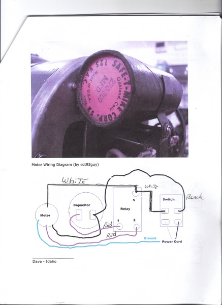

This GE Motor uses a start relay instead of a centrifugal switch.
[ATTACH]12043[/ATTACH]
The wire between the relay 5 and the capacitor is black, not red. I noticed the schematic of wiring is not correct, so disregard the attached images. I will redraw it tomorrow. Sorry. Contact me if any questions. Thanks.

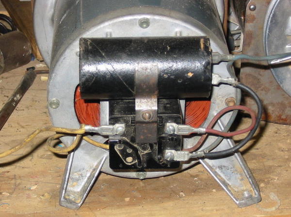

- IMG_0732.JPG (60.94 KiB) Viewed 10157 times

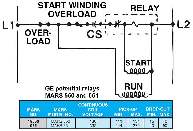

- GE_Potential_Relay_Mars_550_551_3.JPG (42.77 KiB) Viewed 9466 times

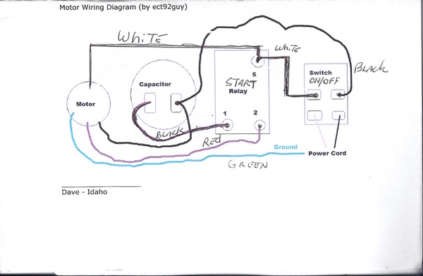

This is a corrected schematic for the 3/4 HP GE motor. All I need is someone to graph/draw this schmetic with colored and straight lines. Thanks.billmayo wrote:This GE Motor uses a start relay instead of a centrifugal switch.
[ATTACH]12050[/ATTACH]
- Scan_Pic0003.jpg (57.93 KiB) Viewed 10029 times
I think Jamhard also needs to know where those wires are connected internally also(he been moving em!).billmayo wrote:This is a corrected schematic for the 3/4 HP GE motor. All I need is someone to graph/draw this schmetic with colored and straight lines. Thanks.

Bill I did up a quick and dirty color schematic of what you posted hopefully this is what you were looking for colors added for clarity.

Bill,
Here is my very quick and dirty edit of your schematic adding colors as you asked for.

I believe the 'red' wire is for the start windings.
When the motorstarts, the capacitor gets charged, the voltage causes the potential (start) relay to open, causing the start windings to be out of the circuit. this usually happens in less than a second. The start windings are just as named, to get the motor spinning.
Some motors use a centrifugal switch to accomplish the same thing.
