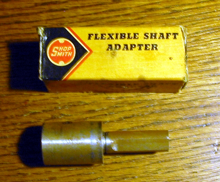

The box states "The Flexible Shaft Adapter secures any flexible shaft with 1/2" bore to the Shopsmith 5/8" spindle........not required for standard Shopsmith flexible shaft" The adapter has a 5/8" bore with a 1/2" shaft with a flat on it. Hopefully, I attached a picture of the adapter and box.
So, if you got a standard Shopsmith flex shaft it should fit right on the quill or aux. shafts.
- flexadapt.jpg (374.54 KiB) Viewed 33522 times
