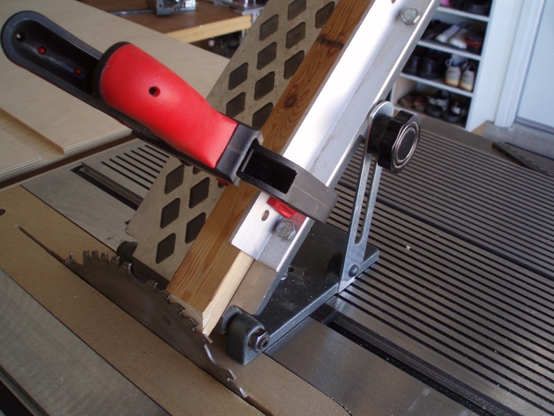

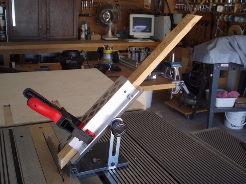

For boards not much more than about 6" wide, I use this setup frequently. The end of the fence makes an excellent reference point but I must wear my glasses to get reliable, repeatable lengths.
[ATTACH]12492[/ATTACH]
[ATTACH]12493[/ATTACH]
:)Do these count as "shop pictures" for that other thread?:)
