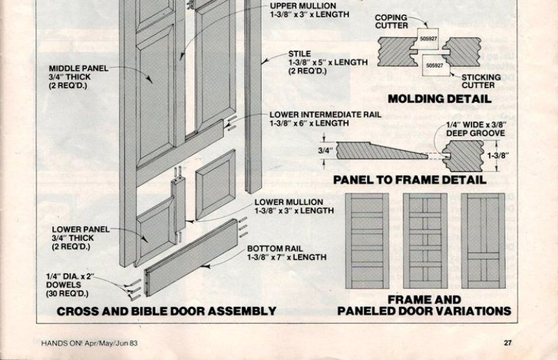

This may or may not be useful to you but I thought it was interesting. This is from the Spring of 83 issue of "Hands On," Shopsmith's former magazine.
[ATTACH]12721[/ATTACH]
[ATTACH]12722[/ATTACH]
[ATTACH]12723[/ATTACH]
[ATTACH]12724[/ATTACH]
If you would like the PDF copy of these images, send me a PM with your email address.
