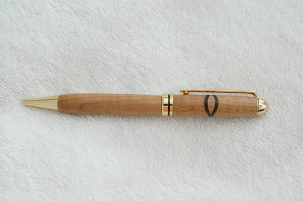

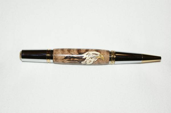

welcome to the forum. I find that the SS lathe chisels are as good or better than most of the others. I have a set of SS chisels and they are my "go to" tools. I have recently gotten a set of Benjamin's best from Penn State and the tool steel seems to be of the same quality but I have not used these yet. I also have a set of older Millers Falls chisels that are high carbon steel and these do take a very fine edge but the edge does not last as long as the edge on the HSS steel tools.
If you are trying to decide go for the SS tools if they have not been overground. Some of the Craftsman tools that I have used have short handles which I don't like. The longer handles give more control and I use my SS chisels for pen making. Take a look.
[ATTACH]12791[/ATTACH]
[ATTACH]12792[/ATTACH]

- eagle pen 1.jpg (65.2 KiB) Viewed 9432 times
- inlaid pen.jpg (78.29 KiB) Viewed 9424 times

Great looking pens!!!
