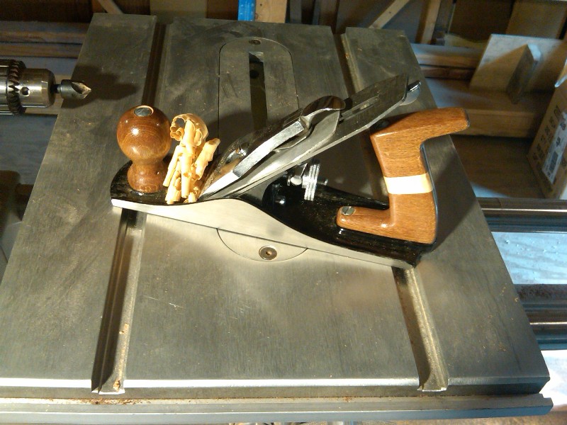

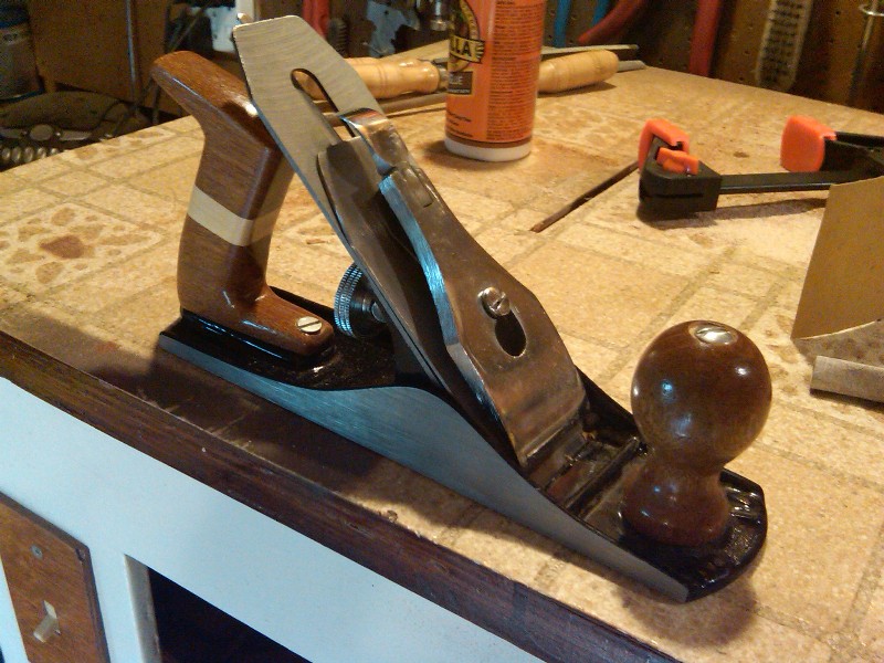

I wanted to share some work I did on a cheap hand plane I recently acquired. It had plastic handles and I wanted to replace them with wooden ones using my Goldie. The front knob was turned on the SS. The grip was rough cut with a hand held jig saw screwed to the bottom of a worktable (I don't have a band saw). The greatest convenience with the SS was the disc sander. That enabled me to quickly round the grip to its final shape.
The handles are mad of red oak I had laying around the shop and a strip of alder (courtesy of Mark/mbcabinetmaker) for an accent. The long grain in the grip runs parallel to the sole which provides strength for the fingers on the top and bottom of the grip. A carriage bolt runs through the center to provide cross-grain support.
Lastly, I used a 1400 grit pad on the sanding disc to smooth the sole and it put a near mirror finish on it.
