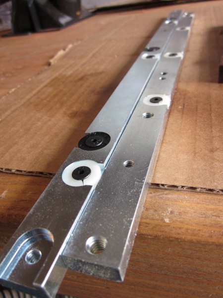

I forgot, one more mod/tweak that's pretty minor but I really enjoy and use a lot. I was using an Incra SE1000 miter bar and really liked it, but found it wasn't available for the SS miter slot size. One day, they were on mega-gold-box sale (or something) on Amazon, and I figured I'd try to make it work, and if I couldn't I'd resell on eBay (or something). Wasn't really a solid plan.
The point of interest is that Incra sells parts to all their products, much like SS does. I ordered a few of the SS-sized miter bars from the 120 model (available from SS). This ALMOST worked out of the box, but only one of the threaded holes didn't line up. I ended up drilling and tapping all three to fit the SE1000, and... check it out:

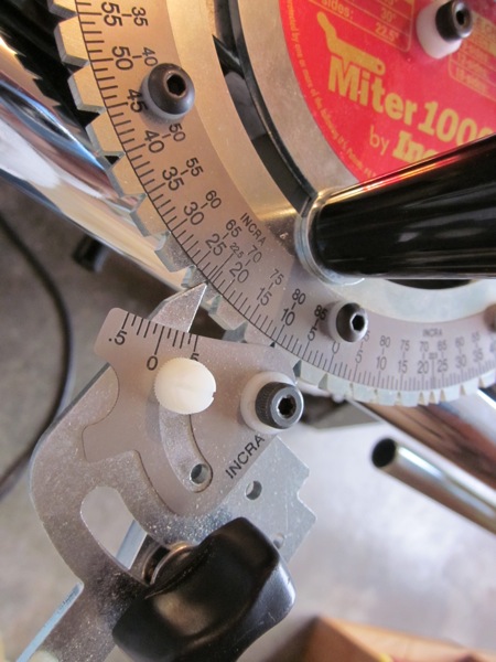

The newer version (HD model, I think) has more tick-marks, but I actually prefer this way. Fewer and larger means you're never going to be one mark off. Plus, the vernier scale allows for infinitely fine adjustment when needed. I personally view the single-degree increment version as overkill -- just more than needed.

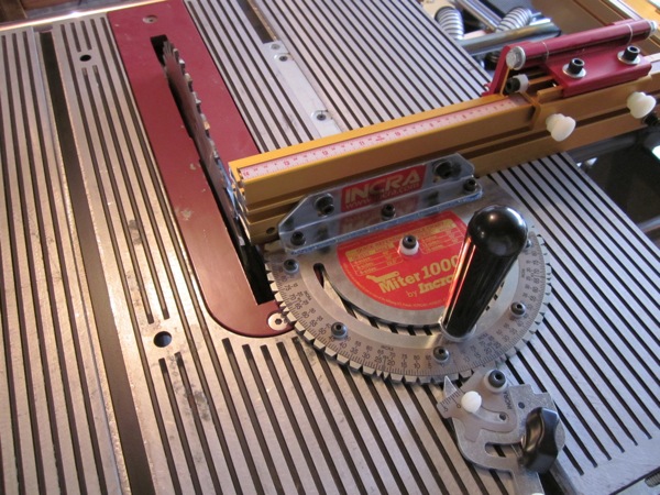

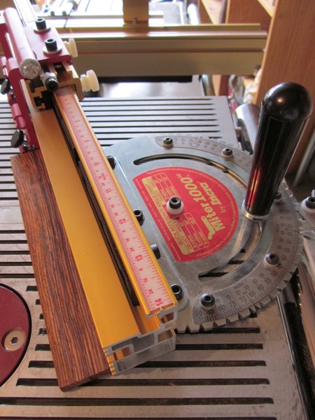

Well, speaking of "more than needed," one of the reasons I like this bar is its ability to swing a FULL 90 degrees in both directions. Requires side-to-side adjustment so you don't hit the blade, but it's just nice to know there's no limiting factor there.

For comparison, here's the original miter bar next to the SS-sized one. If anyone wants to try this for themselves, I'm sure I can spare one of these extra bars, so just let me know. I have two that are already tapped and ready for this particular miter system.
