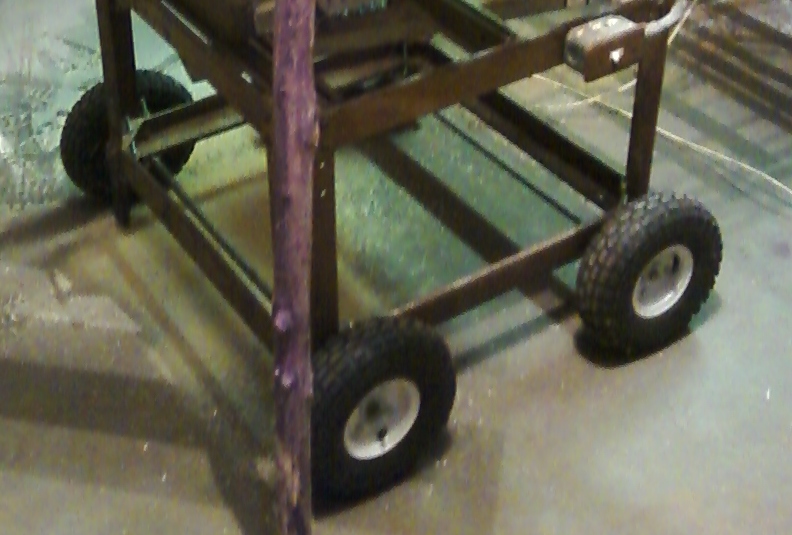

Micheal, I know exactly what you mean about not moving that saw without wheels. I have an old Craftsman 100 that I needed to move around in the garage to use and then put back against the wall. (4) pneumatic tires from Harbor Freight; (2) 36" lengths of 5/8" round steel; (8) flat washers; (4) cotter keys and (4) U-clamps from Home Depot and you're mobile!

Hey Goofy,
Can you snap a couple of pics so I can see that setup? Sounds doable and cheaper than purchasing the Herculift that came with the saw originally. I really need to get this saw mobile and it weighs over 300# so moving it with pure brute force is not really an option. Thanks!

Here's a cropped view from a cellphone pic I had already.
I'll get a couple good ones up soon, but this should give you the general idea. Your base may differ, just alter the concept to fit your saw.
I know it's kinda redneck, but it was cheap and effective. I just put a couple of scraps down as wheel chocks. Mounting the wheels in the other direction would be just plain silly!:D ...unless you like chasing down your tablesaw !!!
Also, these pneumatic tires allow me to roll the saw over turf as well.

dlbristol wrote:No problem here Goofy, I always thought " Cheap and effective" was the definition of redneck!:D
Really! I think more along the lines of KISS!
Or Elegant Solution.
Using the wheels off Mama's Miata would be redneck!
