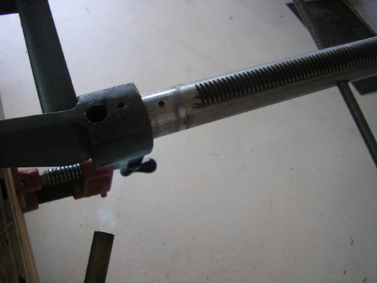

I've been wrestling with the table height tubes on my 500 table since yesterday. I want a tube out so I can make a custom steady rest for turning wood. Without breaking the casting I've tried everything I can think of after popping the roll pin. Pulling, bearing puller, turning...just everything. So after much thought I'm going to cut the casting on the side. Luckily I have another table but this is a real pressed fit. Moral to the story, don't try it unless you have a backup table and can stomach cutting.

Here we go. I did heat it and it did move out of it's house. Here are the pics for those of you who need to know how to do it.
First heat just the casting. I did drill a hole in the tube itself to put in a rod to help turn it free. There is a hole in the casting above the rollpin. inset a screwdriver between the casting and the tube and flex it to push the tube out. I used the rod through the tube to turn the tube back and forth to loosen it. Note, keep the falme right oon the casting and heat all the way around.
[ATTACH]14176[/ATTACH]

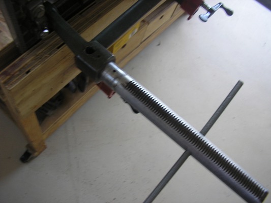

Free at last. Should have heated it yesterday. I guess I was too preoccupied with my bearing puller. Do you need a hole in the tube? Made my life very easy so I could turn the tube and tap with a hammer. It will have no effect on it's usage in the carriage.
