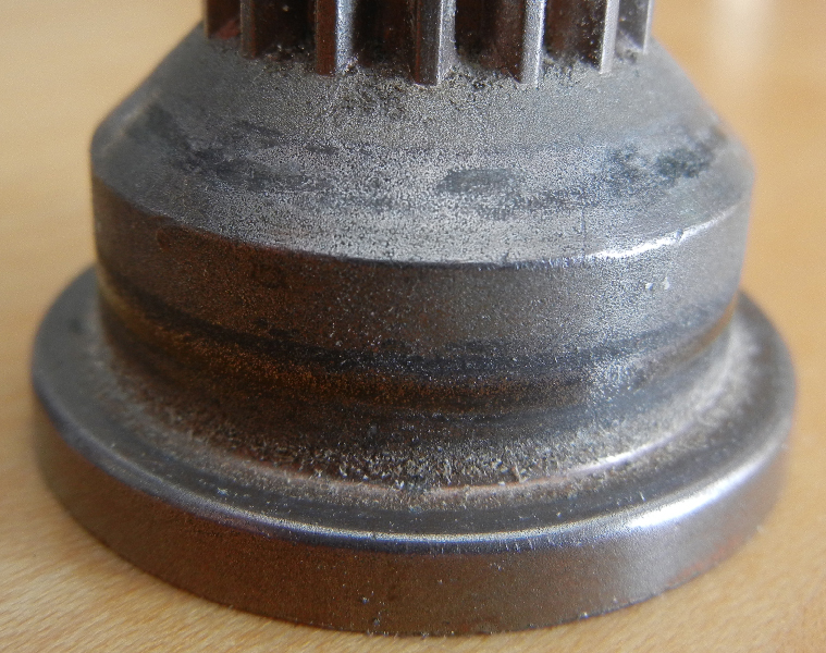

Here's a close-up of one of the pinions (they both look about the same). I don't see anything wrong or worn but I'm not sure what they look like when they are new. I've checked that the pinions/square rod/lock nut/etc. are installed properly but I still can't seem to get the table to not move down with use. The tubes with the rack seem to be in good shape too. Any ideas?
[ATTACH]12862[/ATTACH]
- Pinion20.jpg (425.79 KiB) Viewed 4846 times
The rack and pinion have nothing to do with your problem. Problem being that the table height lock does not secure the table at the determined height. The rack and pinion, if bad, would make it difficult to move the table up and down. The table height lock is basically a friction device involving the way tubes and the locking (mating) face of the part pictured. Clean the racks and the tubes of all wax and crud and put it all back together.
Good luck.
Good luck.

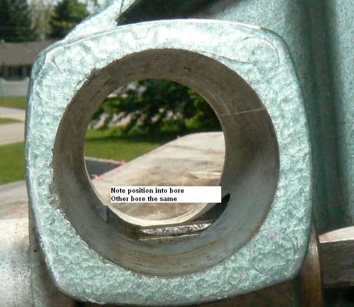

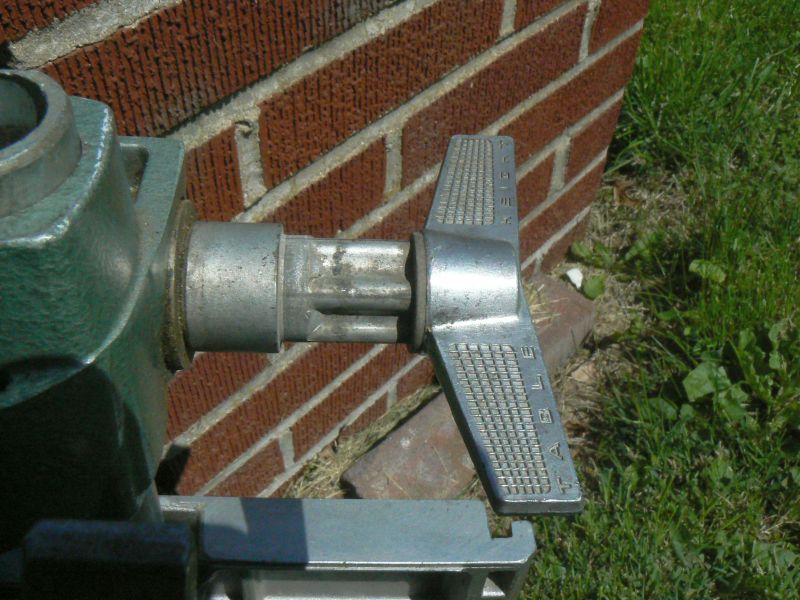

MarkFive510
[attach]12863[/attach]
Relevant parts with crank collar removed. Nut presses against washer/hub/pinion gear.

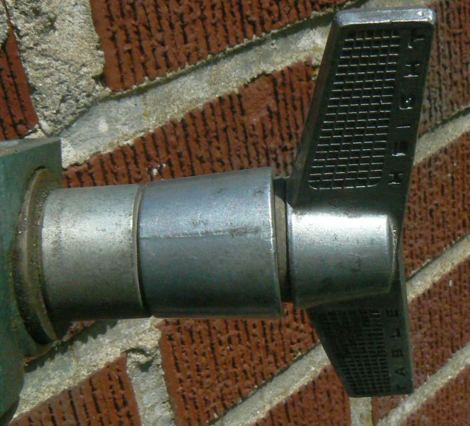

[attach]12864[/attach]
Note collar is shorter than hub .

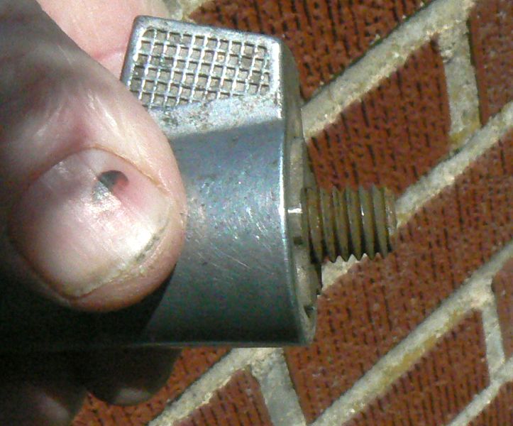

[attach]12865[/attach]
When clamped, collar is 'loose'(washer is not tight against the collar).
[attach]12866[/attach]
When tightened fully(table tubes removed) the pinion gear extends into tube bore about 3/32".
Way tubes not relevant.
