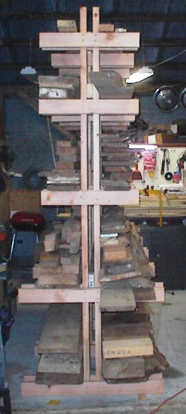

Fiatben, that's quite a nifty lumber storage rack, especially the fact that you have access from both sides. I should build a couple, as my lumber is stacked in a big pile and it would take forever to get at something on the bottom of my mess. One observation I would make is that running that one full length 2x4 and the two shorter ones under the cross pieces, instead of above them, would add to the strength/load carrying capacity of the rack.

I don't suppose you have thought that the 'rack' cost more than the stuff stored on it! Oh that we should ALL have 'that' problem!:rolleyes:terrydowning wrote:Nicely done, we should all have such problems and solutions.

Put the stringer wherever you like! I am sure 'assembly' was easier with it on top!;)

Never even crossed my mind. Good idea, although I suspect the doubled 2x4s with the four 3" screws and glue on each side will hold more than I can put on there. I'm not sure I would try to put a full-length 2x4 in the next one. Maybe it was just the humidity from all the rain, but I had to plane a bit off one end to get the 4th "tree" onto it. Much easier to fit shorter ones between two uprights and put them where I wanted. Of course, I'm gonna watch it for racking, etc. and can alway put some angle bracing in, or more cross members. I've even wondered if I couldn't block in on the lowest racks and put this thing on wheels, but that's a kinda scary thought.pennview wrote:Fiatben, that's quite a nifty lumber storage rack, especially the fact that you have access from both sides. I should build a couple, as my lumber is stacked in a big pile and it would take forever to get at something on the bottom of my mess. One observation I would make is that running that one full length 2x4 and the two shorter ones under the cross pieces, instead of above them, would add to the strength/load carrying capacity of the rack.
I designed it to be basically one board wide on both sides specifically so I could get to any piece of wood without too much trouble. It now takes up about half of what used to be the total area dedicated to WW before I moved a car out of the barn.
End view:
[ATTACH]13156[/ATTACH]

Yeah, I know, but then I had to remind myself how much it was worth rather than what it costs.JPG40504 wrote:I don't suppose you have thought that the 'rack' cost more than the stuff stored on it! Oh that we should ALL have 'that' problem!:rolleyes:

Interesting idea, but this thing is massive in both size and weight. To get an idea, grab 20 2x4s and try to flip them end for end. Each of the four uprights were a handful to maneuver in the shop without taking out lights or hurting myself. I can't imagine flipping the entire thing over. It's not that big of a shop, and I usually don't have help. But, still, interesting thought....pennview wrote:If you turned the rack upside down during assembly, it would be just as easy to assemble and it would be stronger to boot.
Now that I'm thinking about it. I could do a very scaled down version for all those smaller scraps, couldn't I? Naw, I'm leaning toward some really big plywood boxes with lawn mower wheels on the bottom.
'Next' time, run that stringer diagonally forming a 'v' with the point at the center bottom. That would fix the racking concern. I do not think the 2x4 would add much extra support to the arms. A shoulder on the vertical pieces would be more effective.
