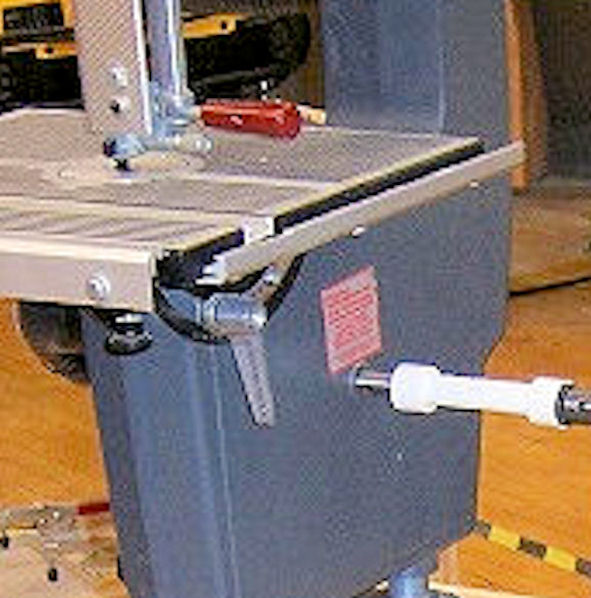

If you have a 5/8" spindle, a Shopsmith drill chuck and all other arbors should fit. Here is a photo found in an old posting of the bandsaw connection (plastic connector between two hubs) to the drive hub on a SS:
[ATTACH]13221[/ATTACH]

The Total Shop does have a 5/8" spindle, so that is some good news for me. I'm assuming the plastic connector piece between the bandsaw and motor will also work. It seems like most of the parts that I need are simply chucks and arbors and things that attach to the spindle, so I just might be in luck.
