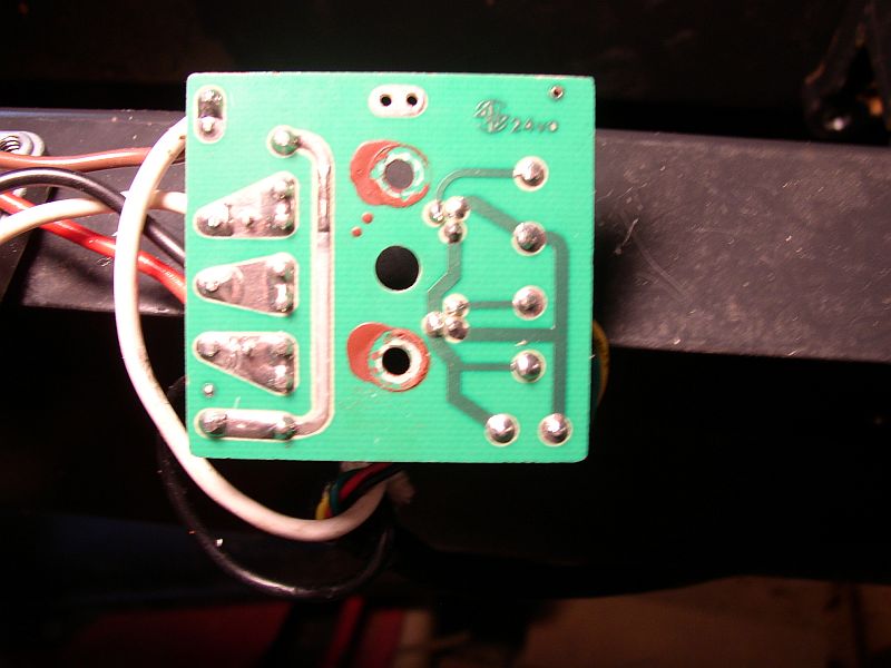

Questions in pix.
[ATTACH]13249[/ATTACH]
I do not think this is a 'stepping' motor.
The 'strange' voltage reading will depend upon what type of meter you are using.
What is under the board on the opposite side(the side the control cable goes to)?.

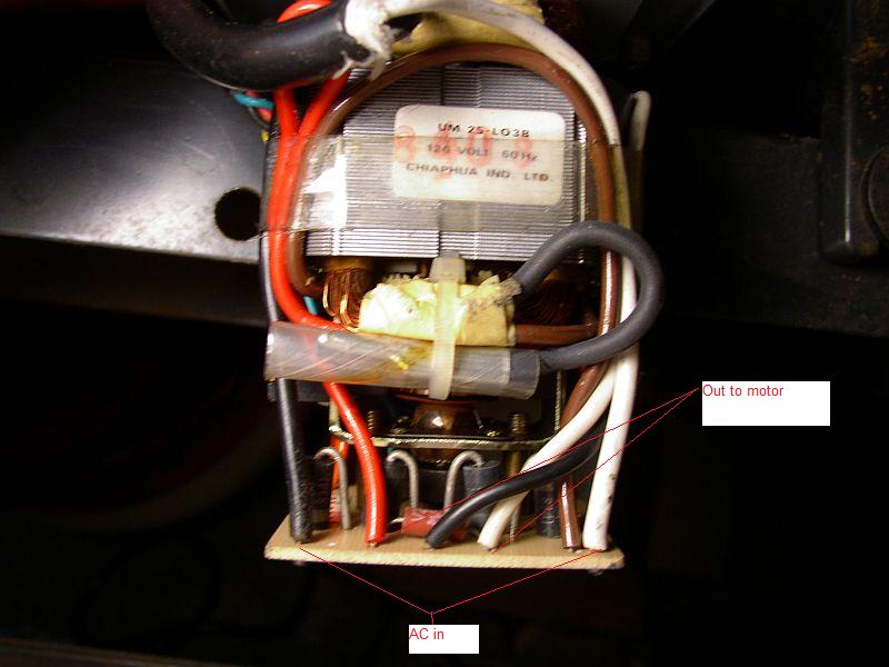

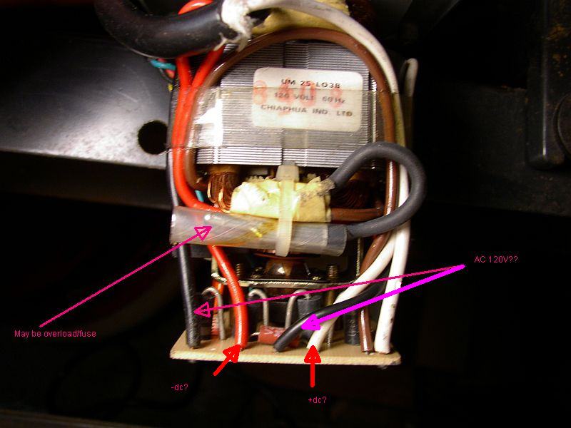

I took another look at things this morning and just raised some new questions.
When looking at the circuit board I don't see a rectifier that converts AC to DC. (second pic below)
The label on the motor itself indicates 120 VAC. The input to the circuit board is 120 VAC. Now the question is what voltage should run the motor and is it AC or DC? I tired to measure the voltage but you see the strange results I got in the previous post. I thought about hooking 120 VAC directly to the motor but am worried about burning up the circiut board or motor.
I do not believe this is a stepper motor. It appears that height is controlled by a sensor. I believe the main contorl panel sends a signal that turns on the motor and determines direction (up/down).

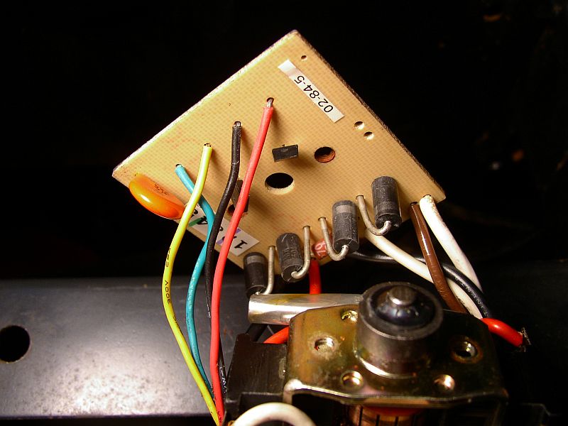

The 4 black things with a stripe on one end are diodes and are connected as a a full wave bridge would. The + and minus outputs are the white wire and red wire respectively. The red thing connecting these points is either a small capacitor or a resistor(cannot see enough of it). Now the power input(120v ac) is unusual in that the neutral(white) only connects to the brown wire. It would be helpful to know what wires go to what on the motor.
The motor appears to be an universal motor(runs on either ac or dc) but the dc polarity will determine direction if field and rotor polarity rare reversed. Cannot tell much about control cable 'side' (wires in way).
Need to know both field winding connections and brush connections.
DO NOT CONNECT 120V AC TO ANYTHING ON THAT MOTOR! I do not think it is 'wired' for direct application(field/rotor not so connected).

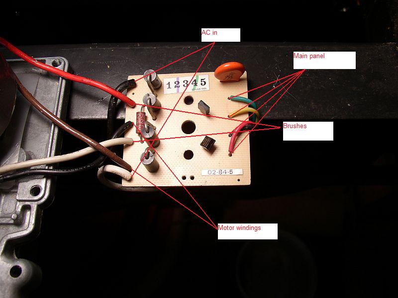

More analysis and pics.
Here is a better picture of the circuit board with the wires and connections annotated. Notice that the brown wire is connected directly to the white of the AC input and then directly to the motor winding. This would indicate to me that the motor is running AC.
Another interesting thing is that the right half of the circuit board is seperate from the left half. You will notice that there is no bridge or components connecting the right and left halfs of the board. I believe that the right half of the board is a sensor circuit that sends the height information to the main panel. I'm not sure how it works unless the two little black boxes are some kind of proximity sensors as there is no physical connection from this side to the motor other than the mounting screws for the board itself.
