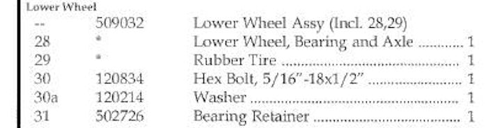

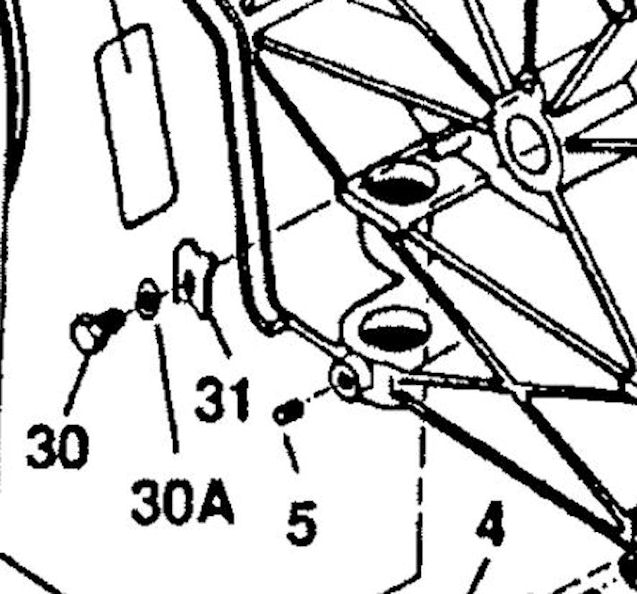

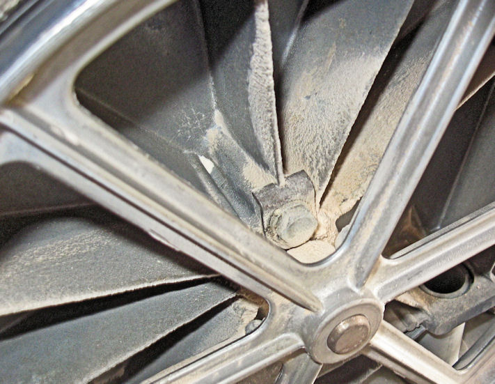

4. You seem to be missing parts 30,30a and 31:
[ATTACH]13238[/ATTACH]
[ATTACH]13239[/ATTACH]
[ATTACH]13240[/ATTACH]
I expect (hope
)others with other opinions will chime in here.
EDIT: note that the above diagram is a screen copy from an old Magna bandsaw manual and may not match the part numbers of today's Shopsmith version.

Not as bad as I thought, then...
The tires are not hard or cracked, so I think I'll just put things back together and see how it runs. And yes, it looks like I'm missing the bearing retainer on the lower wheel. It seems both wheels were pulled at some point and related small parts were lost. Hopefully the SS people stock spares!

I'll spring for genuine parts
Yes, probably I could adapt a fender washer and bolt as the bearing retainer (now that I have Peter's very clear photo) but since I have to order some other missing bits from Shopsmith (like the tensioning spring) I think I'll spring for the real SS part (if they have it).
