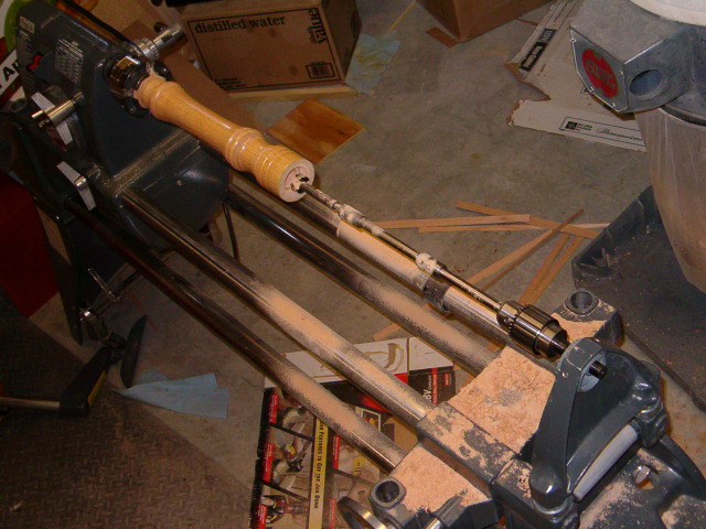

I got all my mill supplies from Craft Supplies USA (The Woodturners Catalog) Also got 6" extensions from them. Actually used two extensions to drill out an 18" tall mill. In order to keep the hole centered, had to drill from both sides. Came pretty darned close! The method worked well!!!
[ATTACH]10652[/ATTACH]
