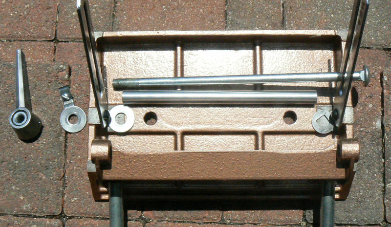

Table is reassembled, but here are the details.
[ATTACH]13404[/ATTACH]a large washer,
The carriage bolt passes through the slot in the back brace(the table pivot), through a square holed washer, the separator tube, a washer, the other table pivot(the front brace), the washer with pointer, and finally the lever nut. Make sure the washer with indicator seats properly into the brace slot before tightening.
[ATTACH]13405[/ATTACH]

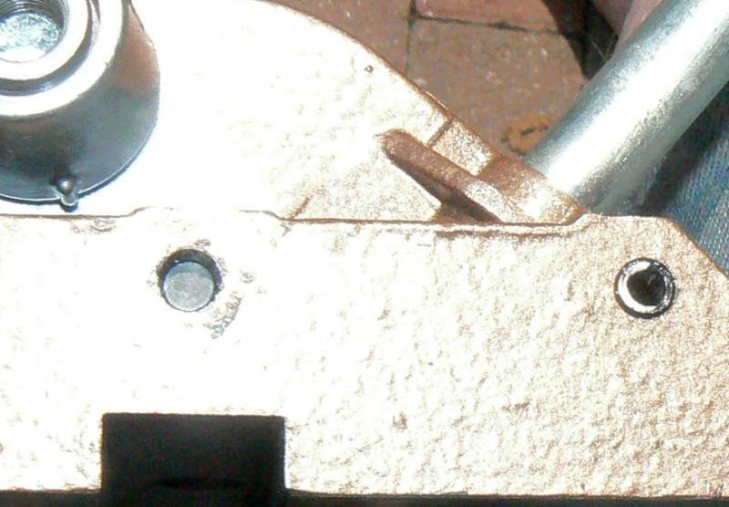

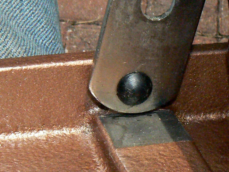

The tension pin that the table pivots on is best driven out from the inside as the holes in the table are larger(clearance so as to pivot) than the holes in the table support.
[ATTACH]13407[/ATTACH]

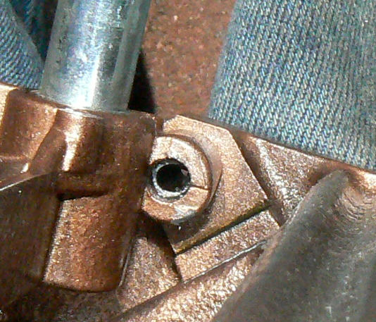

The stud that the slotted braces pivots on is ribbed and has a shoulder under the head. It is driven loose from the edge of the table and when put back, is driven until it bottoms out on the shoulder. Make sure the degree scale side of the braces face out.(at least on the pointer side)
[ATTACH]13408[/ATTACH]
This shows the tension pin and stud from the edge of the table.
