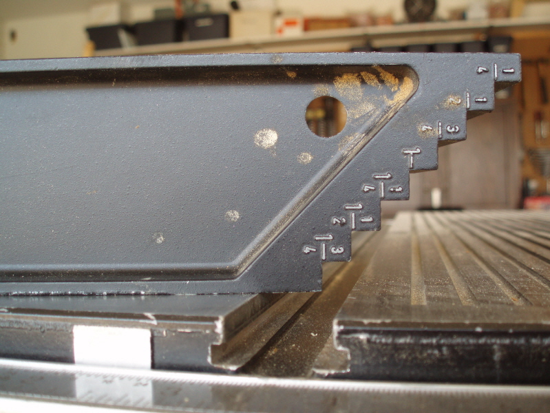

mbcabinetmaker, a short while ago was discussing this issue in his shop. There were a number of depths that he repeatly required. To speed up (I believe not necessarily increase accuracy) he cut a set of stop blocks for under the table.
I thought it was a neat solution so I made mysef a set also. I believe I have six or seven different stop blocks. I have used some of them a few times and now they just take up space in the cabinet.
Why? Not because they don't work. If one was constantly changing AND time to set up was important, I would use them. Time is not that important.
[ATTACH]13510[/ATTACH]
Dusty's One Inch Setup Block

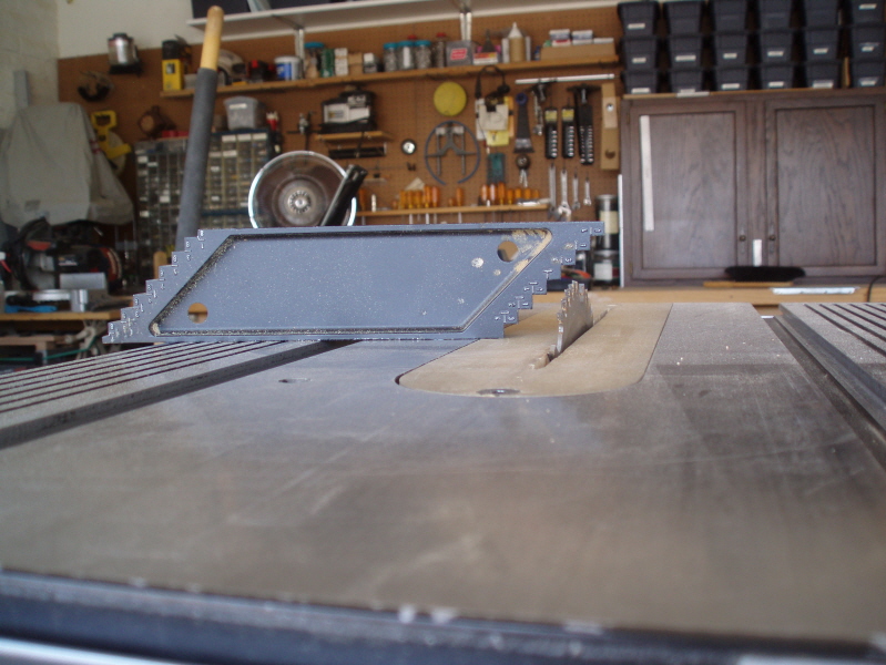

I have a Veritas Gauge that was made for this and if I need an accurate depth of cut setting, I use the Veritas. Otherwise, I do what most of us do. Get it close.
[ATTACH]13511[/ATTACH]
Veritas Setup Gauge at One Inch
[ATTACH]13512[/ATTACH]
Veritas Setup Gauge
NOTE: If I need an accurate setting - I always do a test cut. Never trust a set up procedure for something that requires precision without a test cut.

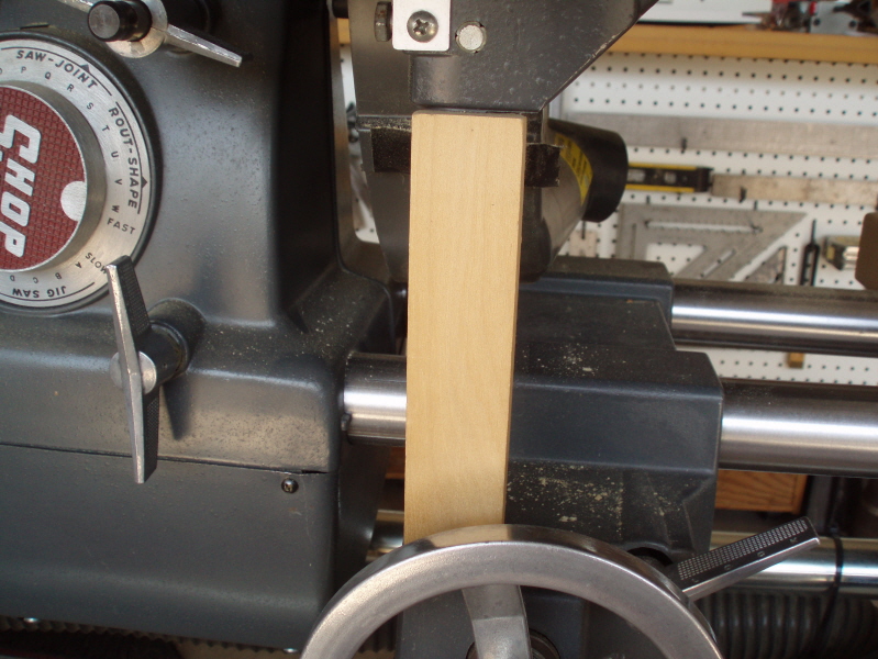

I use a combination square as shown
Abraham Lincoln
Abraham Lincoln
This method just may be better than using the Veritas Setup Gauge because you have the benefit of some tactile feel.anmius wrote:I use a combination square as shown
