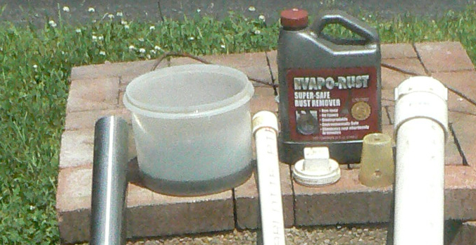

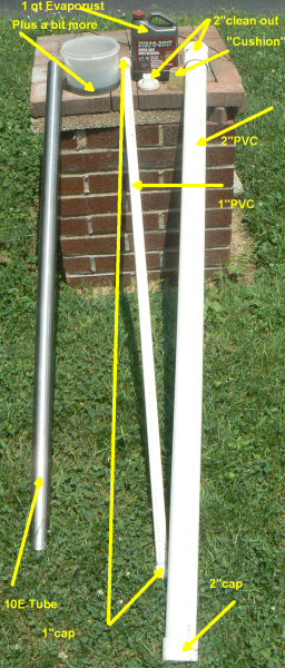

Just to keep the 'record' 'straight'!
5' 2" pvc 1 end cap 1 cleanout
<5' 1"pvc 2 end caps
< 5 min (each end) polishing by holding paper while tube is spinning slowly.)
[ATTACH]13610[/ATTACH] The small cup prevents the tube banging against the end cap(That end cap is actually a cobbled plug from a coupler and a plastic plug glued on).
[ATTACH]13611[/ATTACH]
I find this method much more 'palatable' than spit shining them. I can get 8 hrs sleep while they are being 'processed'.
Works well on light rust.
