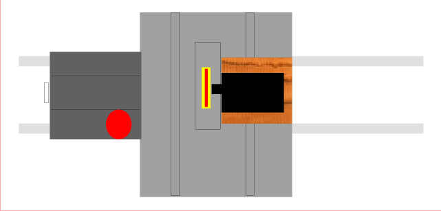

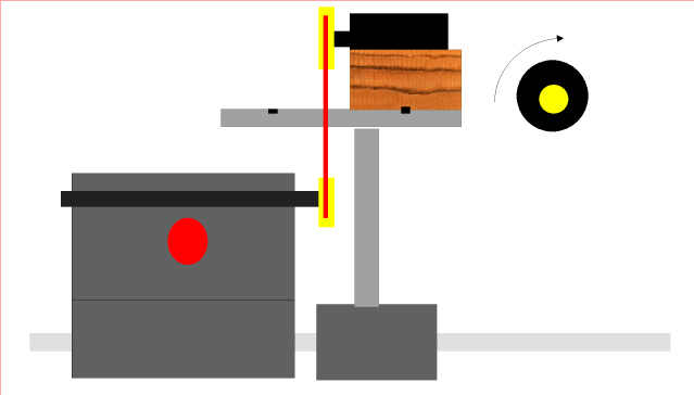

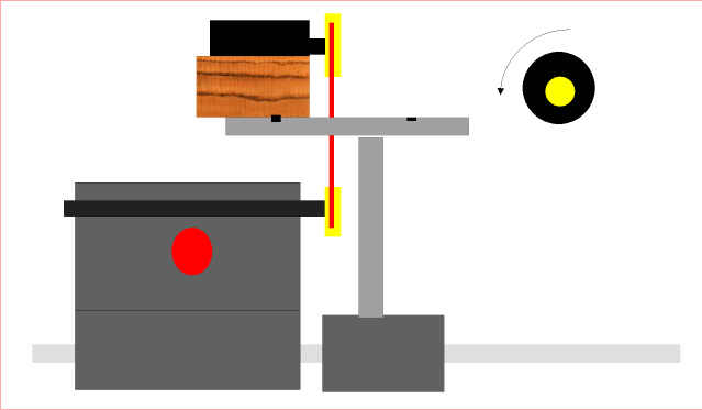

I have no idea of what your set-up looks like but I did a very quick sketch showing a super simple way of having the headstock stay in its normal position, use the main table and an adapter to hold the part to be tested, use the main shaft of the shopsmith with a pulley... remove the saw insert and put the belt through the hole... use the table to adjust the tension on the belt (you might need several belts depending on pulley size) and have an easy way to spin in either position. Given I don't much about what you are doing but this seems like at least a starting place to go from....

- top view.jpg (12.59 KiB) Viewed 15560 times
- clockwise view.jpg (11.56 KiB) Viewed 15548 times
- cclockwise view.jpg (12.39 KiB) Viewed 15540 times
