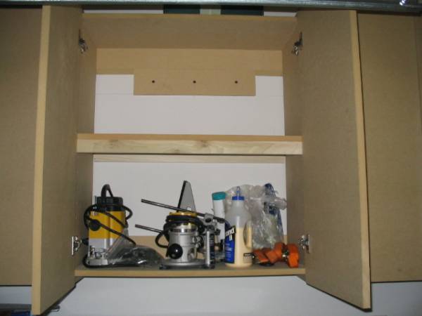

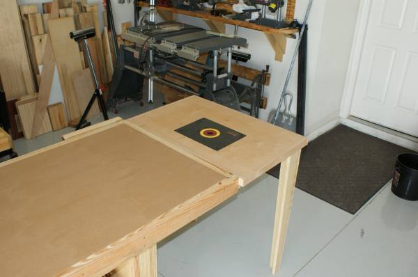

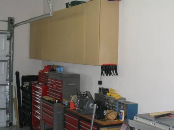

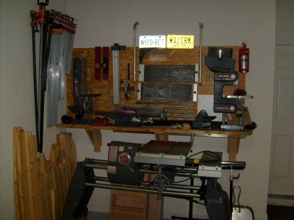

Man,that is a lot of stuff in 1/2 of a two car garage. My shop is in an extended golf cart garage and is about 12 wide and 22 deep. The name of the game is storage, storage and more storage. I think that you will be like me and move the car outside when you work. I made a storage wall for my SS stuff and built some wall cabinets for a lot of the hand tools. Whatever you do you will be making a lot of changes as you and your work change. Anyway here are some pix of the cabinets to try to help. They are held on the concrete block walls using french cleats and tapcon screws and have been moved twice already.

Bill V
