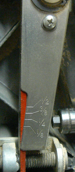

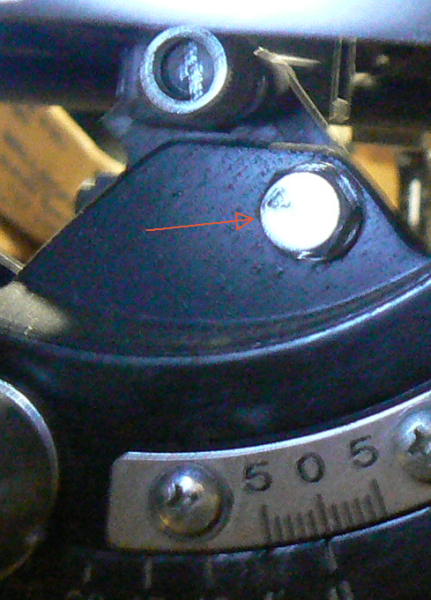

The following adjustment is done with the blade removed and the tension adjustment screw backed out so as to make the upper wheel and scale and spring free floating.
Tension scale slack
tension bar slack.jpg (363.92 KiB) Viewed 55546 times
Note the back edge of the spring bar(red) is out from the edge of the scale.
Tension scale adjusted
tension bar adjusted.jpg (274.83 KiB) Viewed 55518 times
The scale is moved so that that edge is along the back edge of the spring bar. I find it interesting that the bottom edge of the scale also aligns with that edge.
While holding the scale aligned with the spring bar edge, securely tighten the screw.

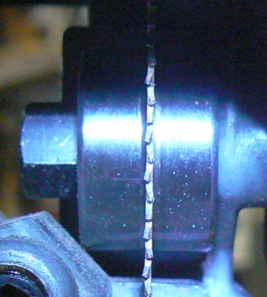

Tracking Bearing Adjustment

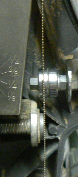

The tracking bearing is one of the things that makes the ss bandsaw unique. It eliminates having to tweak tracking when changing blades and is automatic once adjusted. It also means the back of ALL blades regardless of size will run in the same location so that the blade backup bearings do not need to be readjusted either.
Blade slack
blade slack.jpg (267.27 KiB) Viewed 55541 times
Notice that when the blade is not tensioned(slack) it bulges out away from the wheel.
Tracking Bearings adjusted
tracking bearings alignment.jpg (343.91 KiB) Viewed 55527 times
In this step and all that follow, the blade is installed and properly tensioned for its size. This is to insure that all adjustments referencing the blade are with the blade positioned in a path tangent to both upper and lower wheels(both front and back.)
There are two goals for this adjustment. The obvious one is to position the dual bearings so that the blade tracks in the groove between them. The less obvious one is to make sure the blade is parallel to the sides of the bearings. That also causes the axis of rotation of the bearings to be perpendicular to the blade path(the bearing mounting bolt).
This is accomplished by loosening the bolt that secures the bracket and moving/rotating(slightly) the bracket.
Rotation is limited by a slot in the bracket that slips over a rib.
I test the centering by pulling the blade away from the bearings down near the lower wheel, then when rotating the wheels, observing the bearings moving as the blade returns to touching them. Both should start turning simultaneously.
When ya get it aligned, securely tighten the bracket mounting bolt, then recheck to make sure nothing shifted while tightening it.

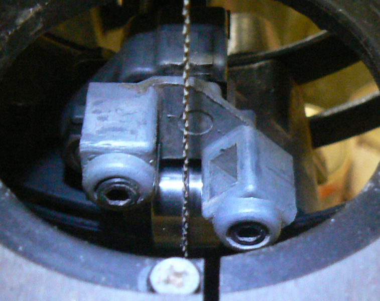

Lower Blade Backup Bearing(s) Adjustment
The lower backup bearing is located below the table behind the blade.
Actually it is a lower wheel guide bearing that does the same as the upper wheel guide bearing.

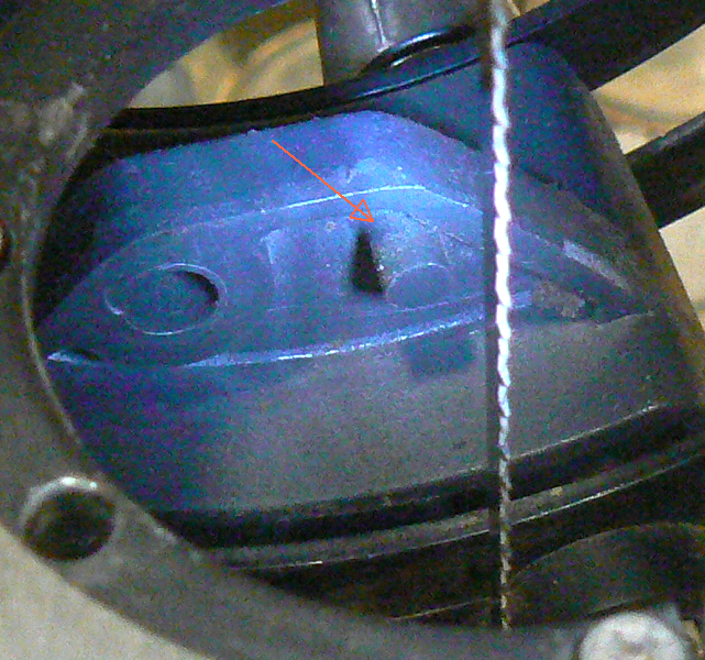

Lower Bearing Bracket Mounting Screw
lower bearing mounting screw.jpg (377.3 KiB) Viewed 55486 times
This screw secures the bracket that must be positioned so that the blade rides in the center of the bearing.

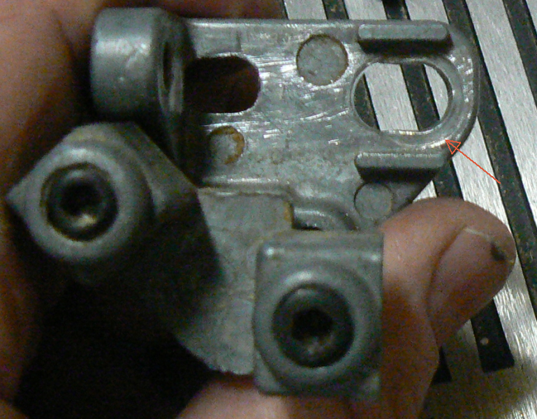

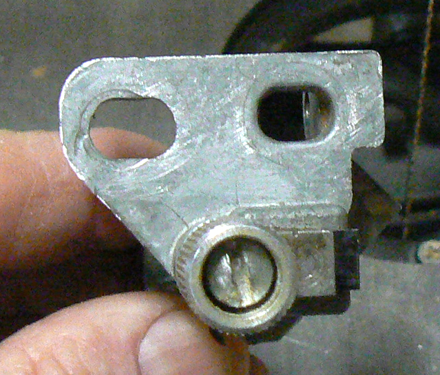

Lower Bearing Bracket Slots
lower bearing mounting slot.jpg (608.73 KiB) Viewed 55537 times
The screw passes trough the slot indicated. The elongated slot allows positioning the bracket towards and away from the throat of the bandsaw. Notice the second slot.
The arrow also points to a deformation of the bracket caused by some PO(Gorilla type) really tightening the bracket mounting screw. The resulting depression makes sliding the bracket difficult.

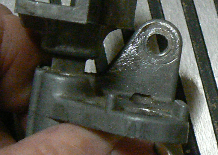

Lower Bearing Bracket Stud
lower bearing mounting stud.jpg (617.45 KiB) Viewed 55373 times
That second slot rides over the fixed stud

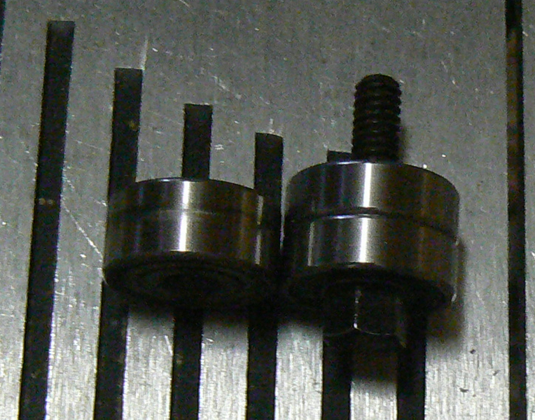

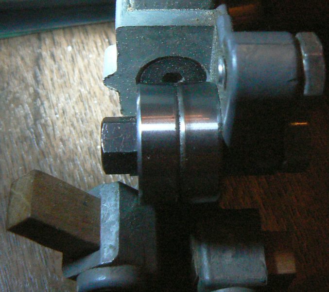

Backup bearings
lower bearing types.jpg (616.84 KiB) Viewed 55350 times
The single OEM bearing is 7mm x 22mm x 10mm. The modified two bearing set is two 7mm x 22mm x 7mm. The original bearing mounting screw has an unthreaded shoulder that is 7mm od. A different scheme used by others uses 1/4" shouldered screws and bushings with 8mm id bearings(8mm x 22m x 7mm. The intended result is to center the blade on the bearing(s). The double bearing sets provide a groove for the back of the blade to ride in(just like the guide bearings). A better choice would be 7 x 22 x 5mm bearings, but they do not exist!
NOTE: The blade did/does not center on the original bearing. With the dual bearings, they must center to the blade.
This procedure will be demonstrated using the dual bearing set shown, but if the OEM single bearing were being used, the procedure would simply be to center the blade on it.
Since the dual bearing set is wider(14mm) than the OEM one(10mm) the bearings must be mounted differently. The lock washer normally between the single bearing and the tapped hole in the bracket must be left out so as to position the bearings towards the outside of the bandsaw. A jam nut(added) on the end of the screw serves to lock the screw in place.

Bracket mounting slots
lower bearing bracket slots.jpg (543.62 KiB) Viewed 55288 times
The file marks shown here and elsewhere are the result of filing those surfaces flat(free of burrs etc.).

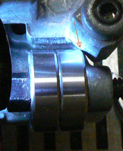

Interference potential
lower bearing interference.jpg (418.95 KiB) Viewed 55244 times
With the wider dual bearing bearings that mount closer to the bracket(no lockwasher) the bearings may butt up against the bracket. This area of the bracket is usually not close to the single(narrower) bearing. There is considerable flash on the corners that must be removed to increase the clearance. The dual bearing set requires the bracket be positioned 2mm further in. This also places the bracket near the limit of the adjustment range(slot end).

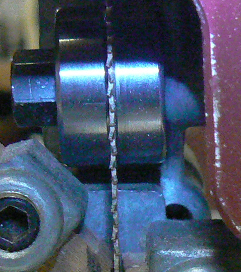

Adjustment done
lower bearing aligned.jpg (601.02 KiB) Viewed 55166 times
After all this parts description, the actual adjustment is simple. Merely position the bracket so the blade is centered(groove on dual bearing or center of single bearing).
Again centering on the dual bearings is tested by pulling the blade out and rotating the wheels until the blade once again contacts the bearings. The blade should contact both bearings simultaneously(that implies the blade does not snap into the groove from either side). I recommend temporarily increasing the blade tension while checking this to ensure the blade is straight between the two wheels.

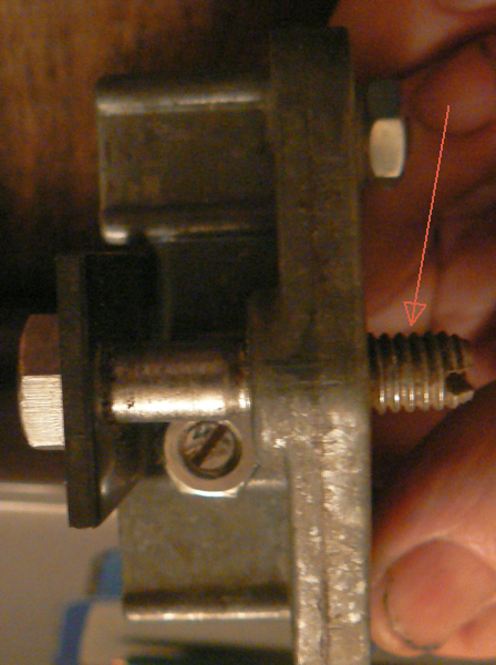

This screw has a slot in the end opposite to the head. The head presses against the spring on one end, and the other end of the spring presses against a rib in the base casting. Rotating the screw clockwise decreases tension. As the post front/back parallel to blade screws are adjusted(see next post), the tension may need to be readjusted. Those two screws press against the side of the post opposite to the spring.
I recommend waxing the lock rod.

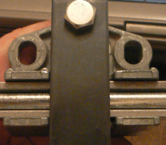

Anti slop screw
upper bearing adj screws.jpg (500.43 KiB) Viewed 55017 times

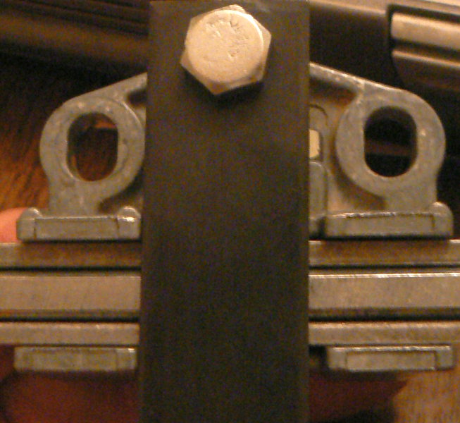

Notice the screw with a jam nut. This screw is adjusted to allow the post to move up/down in the bracket with no slop, but also without dragging. Your bandsaw may not have this or the screw may vary. After adjusting, tighten the jam nut and recheck the post for binding.
FWIW this is more easily done with the post and bracket out of the bandsaw and in your hands.
Post mounting bracket adjustment slots.
upper anti slop screw.jpg (444.2 KiB) Viewed 55051 times
The bracket mounting screws are inserted through the slots and are threaded into the base casting. The slots allow left/right movement of the bracket, but also allow the bracket to rotate.

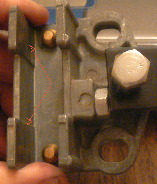

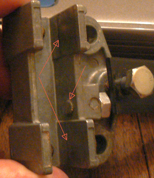

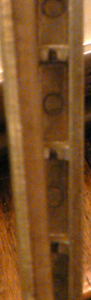

The next adjustment is where difficulty ensues! The next two pix illustrate what is inside the bracket, and how the adjustments position the sliding position of the post as it is raised/lowered.
Outer side of post slot
upper slide guide 1.jpg (482.91 KiB) Viewed 54984 times
Notice the two raised surfaces indicated by the two arrows. The post slides on these two surfaces.
Inner side of post slot
upper slide guide 2.jpg (505.14 KiB) Viewed 54970 times
Notice the double arrows again. The post would slide on those two surfaces, but if the anti-slop screw is present(see the single arrow), the post rides against it.

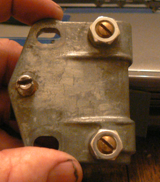

Notice the two brass screws. They are to be adjusted next. The tension spring is rotated away from the slot in these pix, but normally it is positioned across the post slot. The two brass screws are adjusted to position the post in the slot so that when the post is raised or lowered, the post(and attached backup bearing) remain the same distance from the back side of the blade. Thus the back side of the post presses against the lock spring, and the front surface of the post rests on the two brass screws.
The tricky part is to maintain no front to rear slop when adjusting the brass screws. If one is backed out 1/4 turn, the other must also be turned in 1/4 turn.
The adjustments are checked by observing the same distance from the back of the blade to the backup bearing(s). This should be checked with the lock set. It may become necessary to readjust the tension on the spring during this.
All adjustments should be made very gradually (no more than 1/4 turn). The jam nuts must be loosened and snugged as each adjustment is made(loosen nut, adjust screw, snug nut).
To increase the clearance at the top, back the lower screw out, and run the top screw in.
Realize all the movement of the two screws affects the blade to bearing clearance at both the top and bottom positions of the post. You are 'tilting' the post.
A different description of this adjustment is found at post #60 in this thread. Thanks Ed!!!

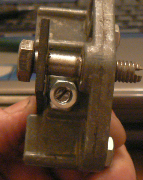

As a side note, the next pix shows the screw that attaches the two parts of the post to each other.
upper post screw.jpg (620.31 KiB) Viewed 54990 times
