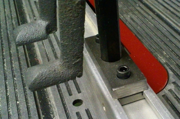

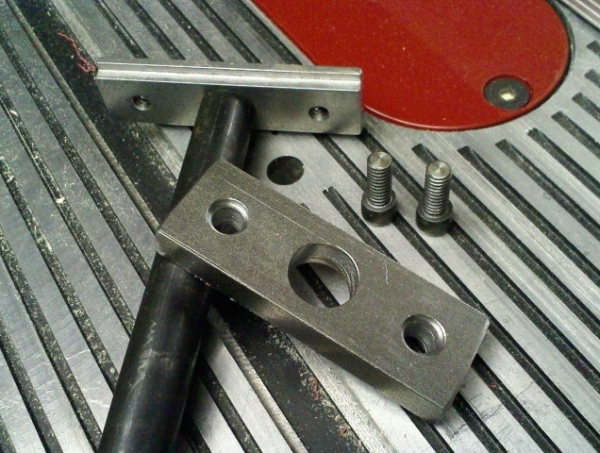

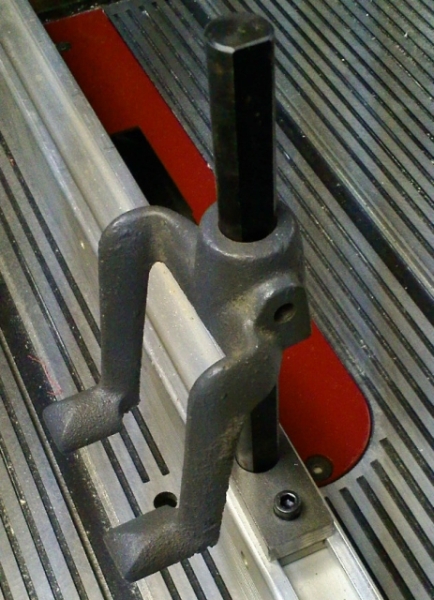

I have just finished 'upgrading' my 500 mortise hold down to be compatible with the 510 T-nut fence. I used one of my T-nuts (https://forum.shopsmith.com/viewtopic.php?t=8403) and simply tapped the bottom of the Holddown Rod for 3/8-16 UNC set screw.

Nicely done! A heavy duty(thick) washer can take the place of the top plate(requires longer 'setscrew'). That way only the 5/8" rod need be rotated to install(tighten)/remove(loosen). At least that's the way ss did it!;)onetrack wrote:I have just finished 'upgrading' my 500 mortise hold down to be compatible with the 510 T-nut fence. I used one of my T-nuts (https://forum.shopsmith.com/viewtopic.php?t=8403) and simply tapped the bottom of the Holddown Rod for 3/8-16 UNC set screw.
