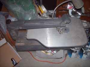

Nope! Like this.
[ATTACH]12871[/ATTACH]

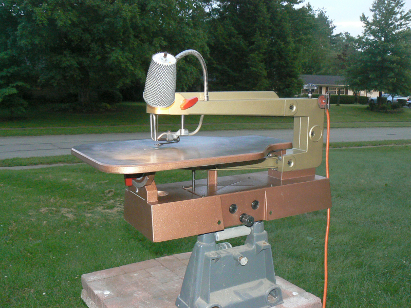

The scroll saw mentioned above now looks like this.
[ATTACH]14022[/ATTACH]
Before (CL pix)
[ATTACH]14023[/ATTACH]
- after reduced.jpg (777.81 KiB) Viewed 6656 times
