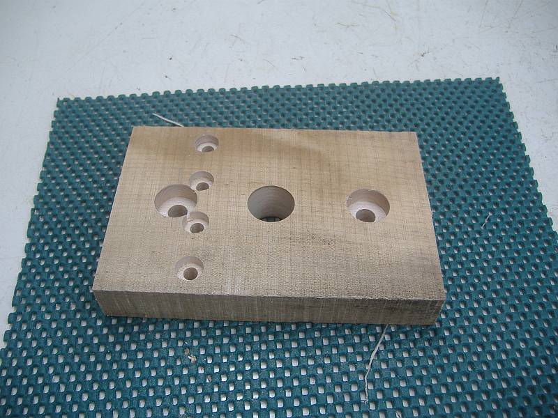

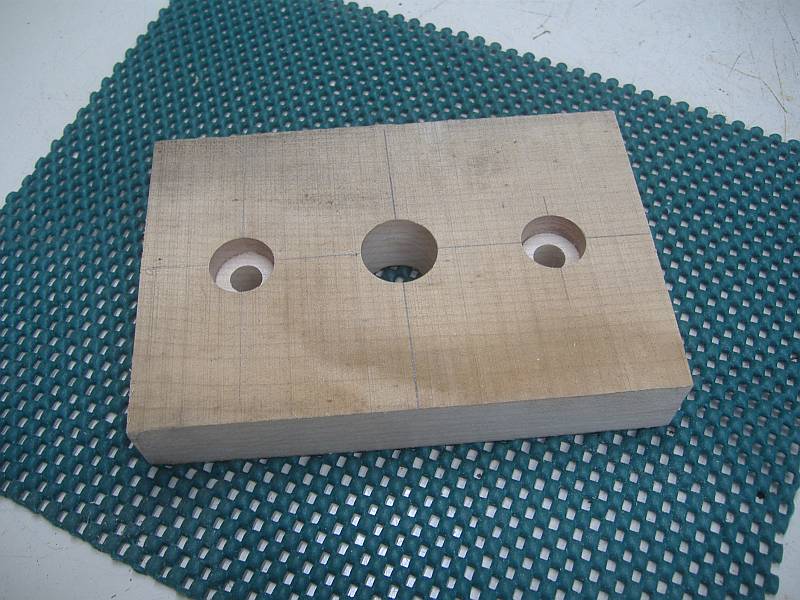

So how about I show you a project I finished today and you figure out what it is for.
I will give some hints to get you started.
Material: maple
Size: 1" x 4" x 6"
Center hole: 7/8" though
Other holes: (2) 13/16 counterbore x 3/8" deep, 3/8" through hole
Other hole spacing 3-5/8"
Picture:
[ATTACH]14152[/ATTACH]
Use: adapter for use on shopsmith 505/510/520 (could be adapted to a 500)
I will post additional images that you might find useful as time goes by.
Note: So far as I know this was just invented today in my shop.
SDSSmith

Hmmmmm, hole spacing between the smaller holes is the same as another project recently completed. 7/8" hole, probably could fit some bar stock a little less than 3/4" wide x 3/8" thick. But,then what would I do?
Rob in San Diego

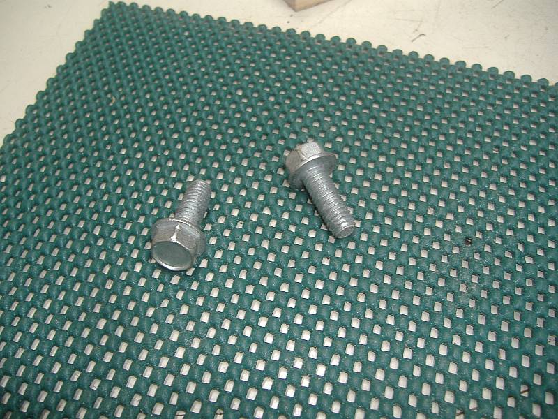

The "bolts" are from shopsmith, they may look like something you have but you would have had to get them from an add-on.
Washer head, length 3/8 thread 1" long.

Yes it is related to the other post:
https://forum.shopsmith.com/viewtopic.php?t=8695

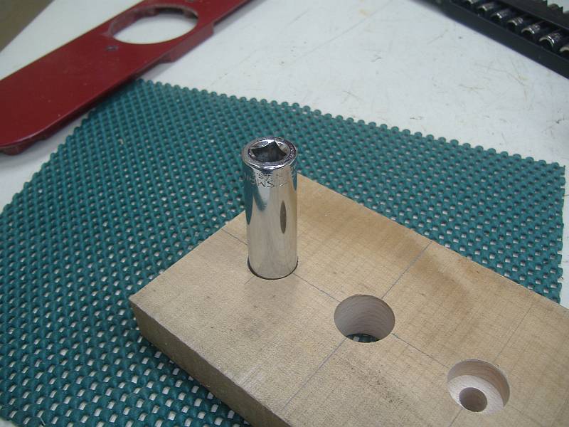

Anyone care to guess why the counterbore is 13/16"? Would knowing you need a 9/16" socket to tighten the bolts help?
Yep I'm sure some of you got it! The hole is sized to allow the socket enough room to let you tighten the bold in the recessed hole.
Check it out:
[ATTACH]14155[/ATTACH]
Pay no attention to anything that might have gotten in the photo by accident or by way of another hint.

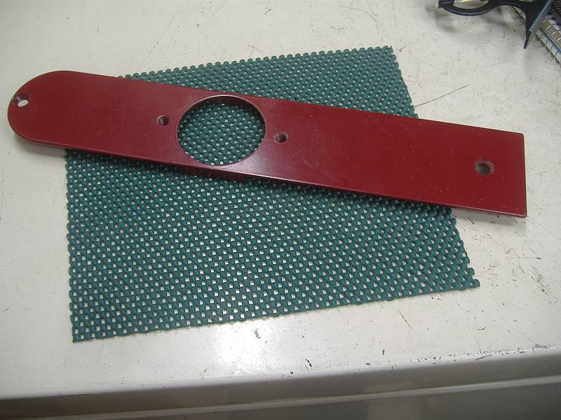

Boy this sure looks like a drum sander table insert (555110). I wonder how all this comes together... or do I?

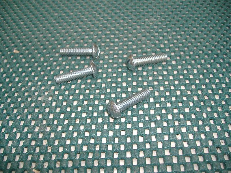

I bet these might fit those new holes:
[ATTACH]14159[/ATTACH]

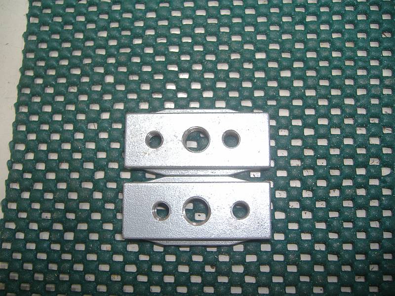

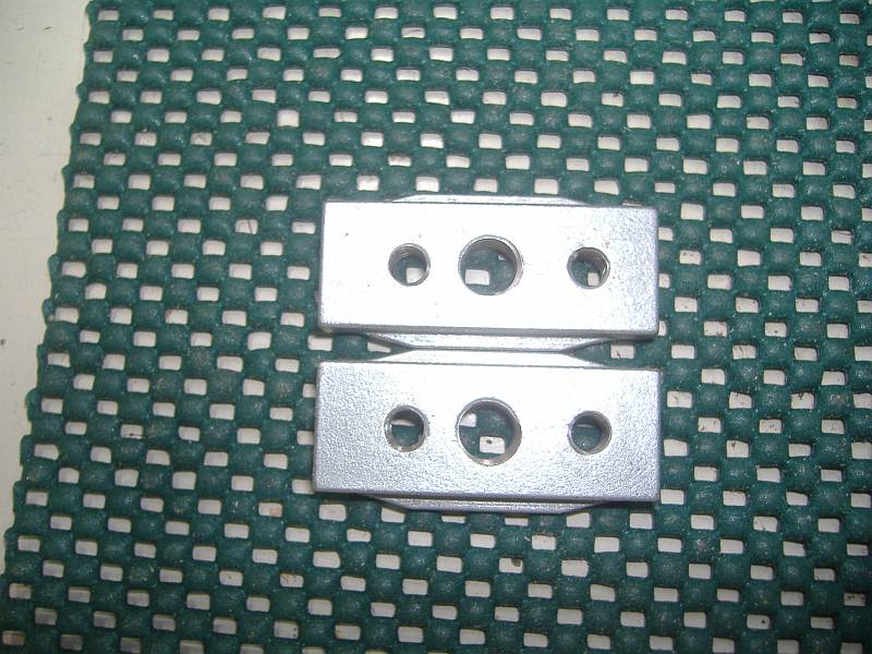

How about we take a little side track and see if these pictures of a pair of t-nuts (555916) show you anything by looking at them.
[ATTACH]14160[/ATTACH]
[ATTACH]14161[/ATTACH]
You may have already noticed this or maybe you have never seen these parts, or maybe you don't see anything to look at.
Hint:
There are two 1/4-20 holes in a t-nut, those holes are what you need to study.
