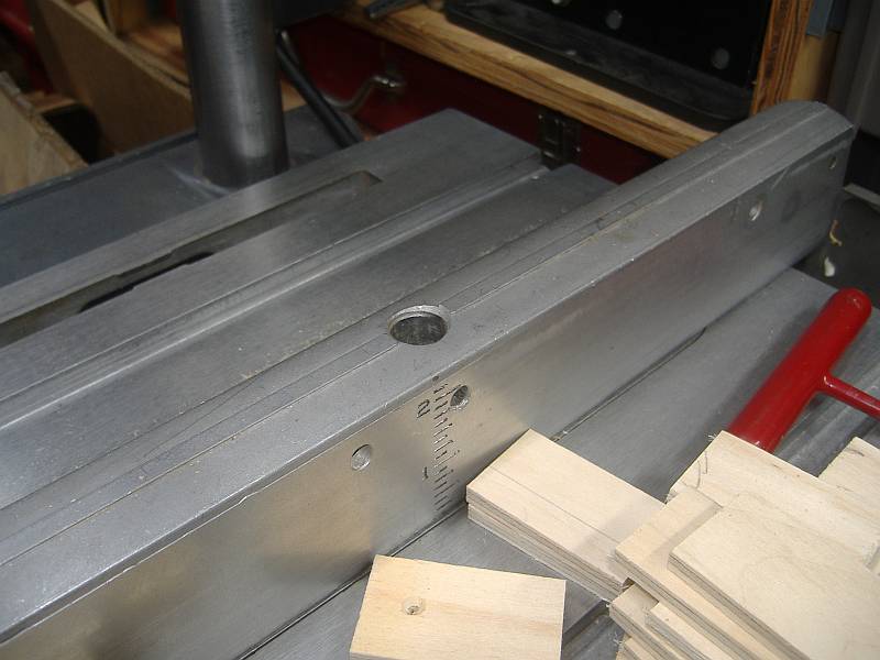

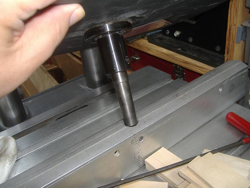

First let us look at the old 500 rip fence, and please note the hole in the top of it. I'm not sure of the proper name for it but is often thought of as the place the mortising hold-down fits in. The newer fences do not have that hole, and I miss it.
[ATTACH]14139[/ATTACH]

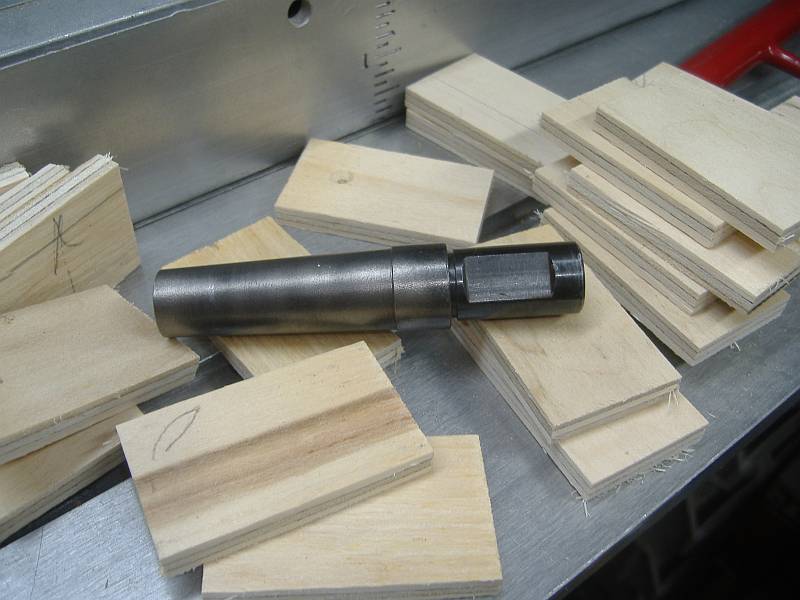

Next you need the tail stock chuck adapter (505603) seen sitting among the trailing hook blanks.
[ATTACH]14140[/ATTACH]

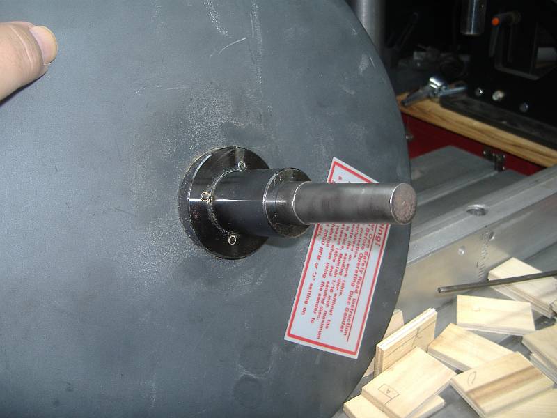

The sanding disk comes next.
[ATTACH]14141[/ATTACH]
As can be seen the tail stock chuck adapter also fits the sanding disk and the whole assembly fits in the rip fence hole.
[ATTACH]14142[/ATTACH]
Keep in mind the rip fence hole is just a hole while the tail stock adapter is a MT-2 taper. However they work together quite well for projects like this.

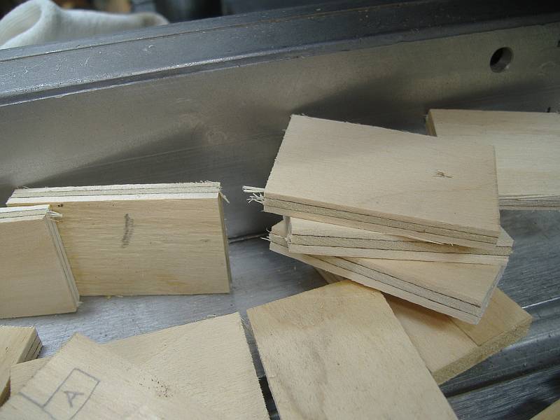

Take a look at the parts that need processing, note the condition of the edges, not as clean as they could be right? They don't have to be perfect but you don't want to get splinters from them either.

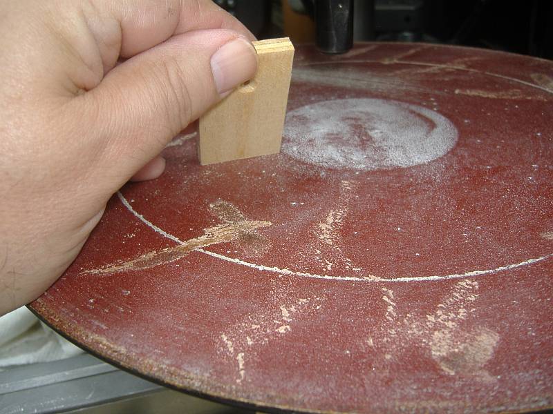

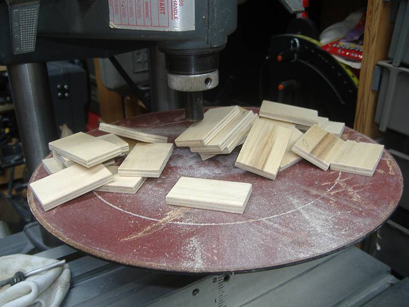

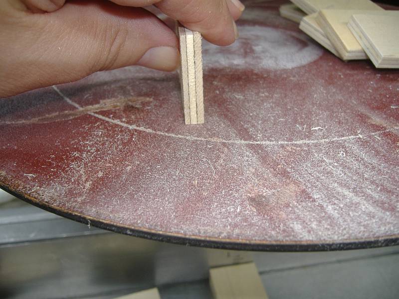

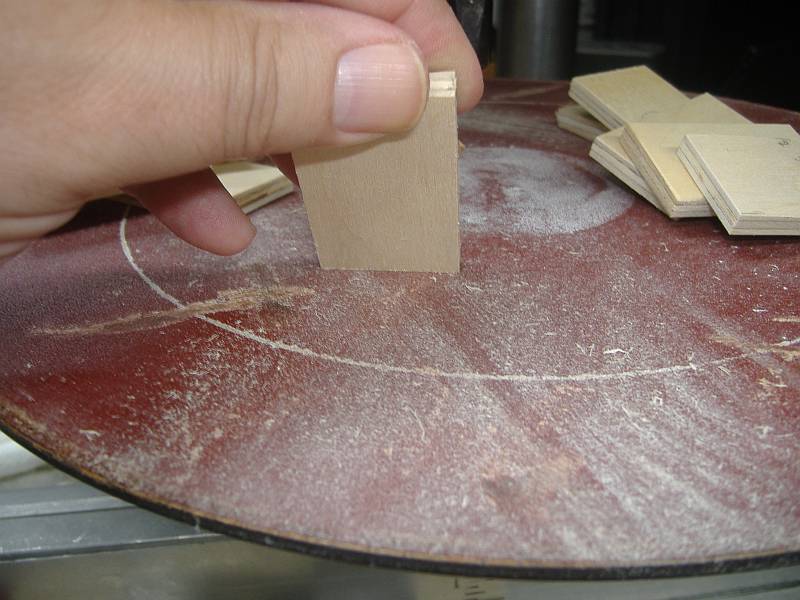

The whole process goes really fast most of the time. I do the corner edges by holding the piece at an angle and drawing it towards me. The edges corners require 8 pulls, one for each corner edge.
[ATTACH]14146[/ATTACH]
[ATTACH]14147[/ATTACH]
[ATTACH]14148[/ATTACH]
Then I finish by doing the 4 edges.
[ATTACH]14149[/ATTACH]

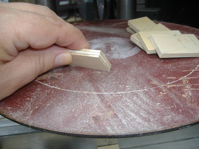

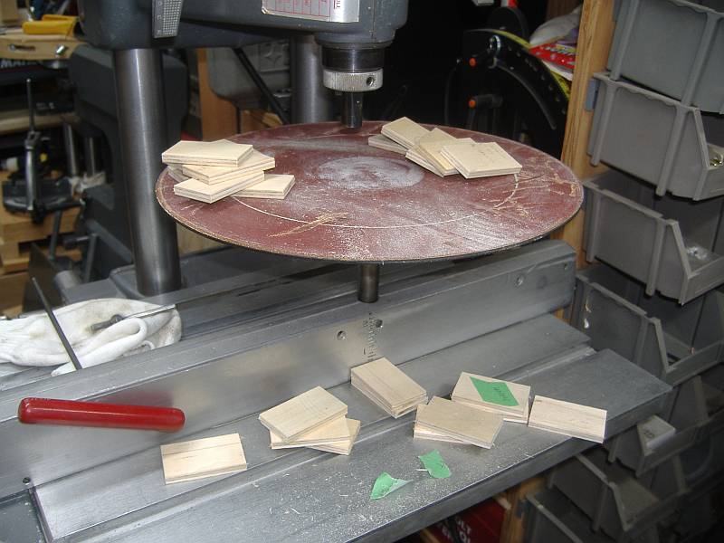

Here you can see how things are going about halfway though the process.
[ATTACH]14150[/ATTACH]
Then when it was done.
[ATTACH]14151[/ATTACH]
This is about all I have for you so I'm up for questions if you have any.

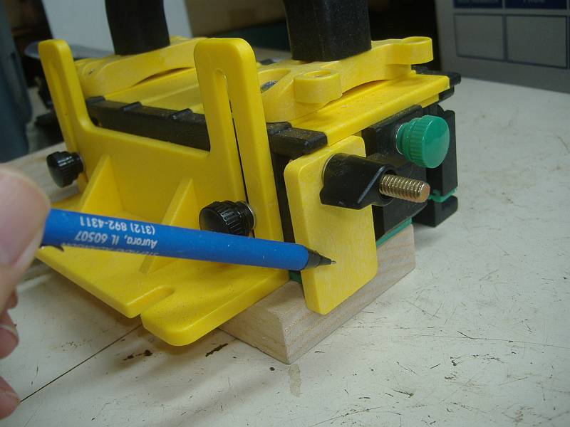

You should now be able to get to the information there to see the information on the GRR=Ripper. They pretty much explain how the system works and some where at the forums I did a review of them.

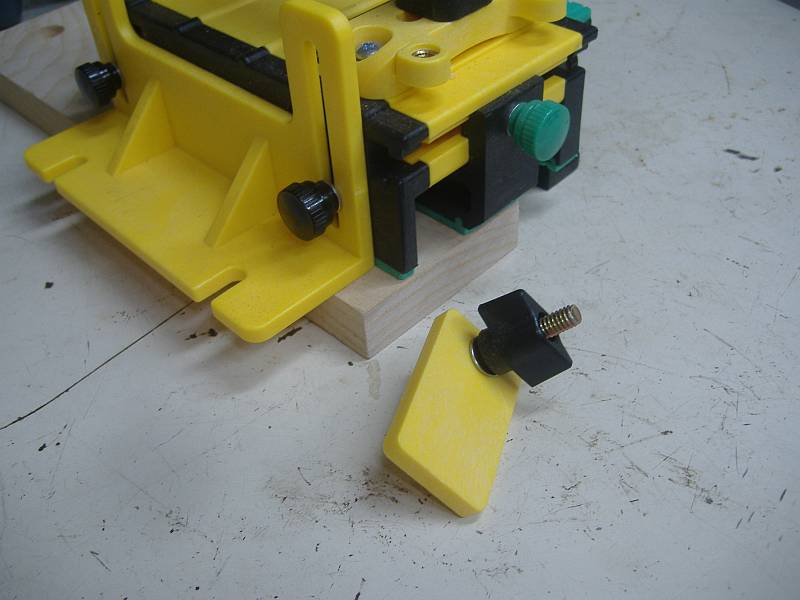

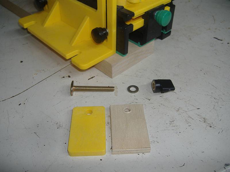

Having said that, the parts that I was demonstrating the sanding technique on were what they call a "trailing hook". During use the saw blade will pass through the hook and after "time" the hook will no longer function and needs to be replaced. The purpose of the hook is to provide support on each side of the material during the rip process as it continues after the blade has passed.
Here are a few pictures showing the provided (never been used condition) hook, then some shots to help make it clear where the replacement ones I had been working on go.
[ATTACH]14178[/ATTACH]
[ATTACH]14179[/ATTACH]
[ATTACH]14180[/ATTACH]
Hope that helps.
