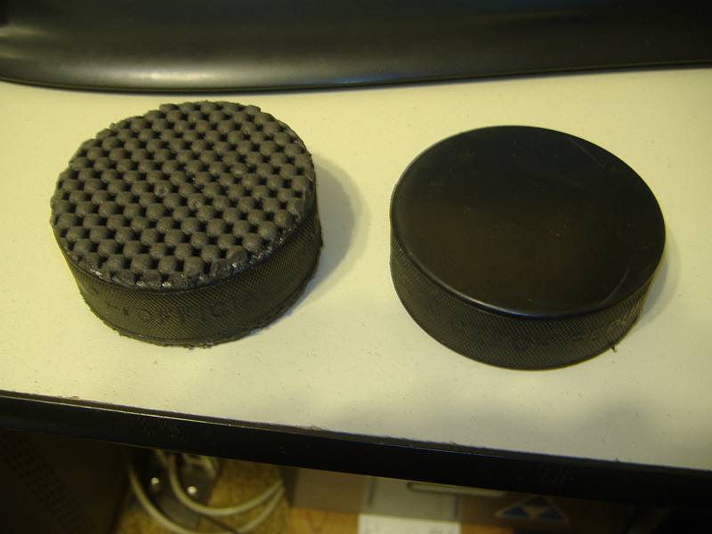

Got out to the store today to check on the prices of hockey pucks. All they had were Made in Czeck Republic... sorry Tim. At a price of $1.29 I got four of them to experiment with.

I used some of the spray adhesive to attach some drawer liner to them. They are about 3" in diameter and tips the scale at 6-1/2oz (or so). I was going to trace the puck on the mat but with black mat it is hard to see so I went with sticking the mat on and trimming later.
[ATTACH]6529[/ATTACH]
They are still untested but it's a start just having them put together.

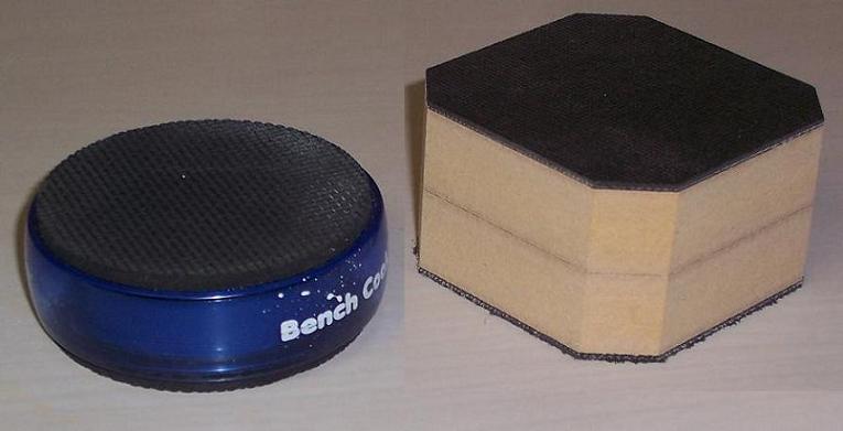

I bought 1 set from Rockler and then built 30 more. I used a double thickness of 3/4" x 10" x 30" mdf. Purchased some black rubber like 1/16" thick shelf liner from Lowes and contact cemented (like you would do a laminate) the rubber to the wood. Then I cut the wood to size on my table saw using my cross-cut sled ( rubber would not allow the wood to slide on the table saw). Cost of the shelf liner was $6, mdf was scrap and it used very little contact cement. So I got 30 blocks for $3.00 and have enough shelf liner for another 30. Spent about an hour making them. Seem to work great. They don't grip quite as well as the Rockler blocks but they do a decent job.

bucksaw wrote:I bought 1 set from Rockler and then built 30 more. I used a double thickness of 3/4" x 10" x 30" mdf. Purchased some black rubber like 1/16" thick shelf liner from Lowes and contact cemented (like you would do a laminate) the rubber to the wood. Then I cut the wood to size on my table saw using my cross-cut sled ( rubber would not allow the wood to slide on the table saw). Cost of the shelf liner was $6, mdf was scrap and it used very little contact cement. So I got 30 blocks for $3.00 and have enough shelf liner for another 30. Spent about an hour making them. Seem to work great. They don't grip quite as well as the Rockler blocks but they do a decent job.

Bucksaw had a great idea. I purchased a set from Rockler and like them so much I ordered a second set. I like them as much as the paint pyramids. Both serve a definite purpose. Jim
