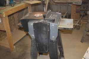

Thanks guys for the feedback. I am going after work tonight to see it, but I'm hopeful it's in good shape. I've seen one small picture of it so far, and it looks decent. The price is very attractive on the unit - I'm not sure I can find a low use 735 for a similar price.
Are tehre any updated parts that I should look for, or maybe better said, are there any upgrades to a possible older unit that I should try to ensure are there?

jschmitz1949 wrote:Thanks guys for the feedback. I am going after work tonight to see it, but I'm hopeful it's in good shape. I've seen one small picture of it so far, and it looks decent. The price is very attractive on the unit - I'm not sure I can find a low use 735 for a similar price.
See post #2 this thread.
Also there was a manual feed(hand crank) version as well as the Mark V mount and stand alone version.
If this is the one, go get it before the seller comes to his senses!!!!!!!]14383[/ATTACH]
- planer ala buffalo.jpg (28.92 KiB) Viewed 5031 times
If JPG has the correct picture (only one I saw in the Buffalo area), then it appears that you might be looking at a Mark V mounted planer on a power stand. It appears as though the table top is stainless steel as opposed to cast iron. You will want to check the power stand motor to make sure it is at least 1-1/2 horsepower. The Pro Planer stand motor is 1-3/4" horsepower.
The SS medalion is in the 'closed' position so it does not appear to have the dust collection upgrade. Not sure of the market in Buffalo, but around here the Pro Planer has been purchased on at least three occasions for around $250. The ad notes new rollers, hopefully the infeed roller is the segmented serrated steel type. As far as possible upgrades, I would be looking at casters and dust collection.
Hopefully, it is new enough to have or has been upgraded to the newer pulleys. You can print out the tables found here (Mark V mount) and here (Pro Planer) if you want to be able to date the machine.
Good luck.
