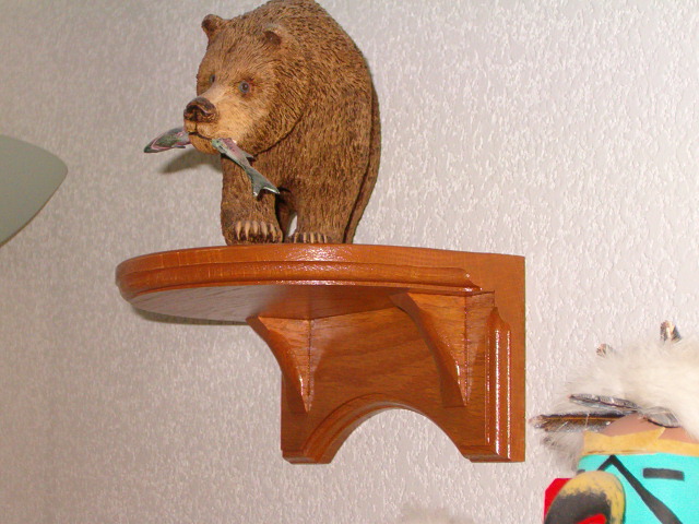

One of the neat things the Overhead router does for you is it gives you the ability to actually watch the stopped groove or dado being made. This way you have line of sight control over the stopping point. That feature is lacking in any under table router. you have to make reference marks on your fence or table and hope they are correct.
I have made several wall hanging shelves and quilt hangers where I wanted to stop the molded edge about 1/4" from where joining parts meet. This has been very difficult for me in the past, with quite a few do - overs, but now with the Overhead router it will be a snap! Example of such a stopped molding below.
[ATTACH]483[/ATTACH]
- HPIM1508.jpg (116.07 KiB) Viewed 24619 times
