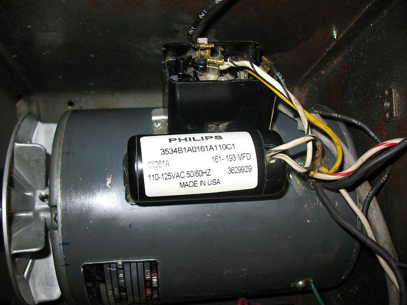

Hello all,
Has anyone seen a motor with an external "motor starting switch" mounted on the motor case next to the starting capacitor? See attached photo.
I have been having intermittent starting issues.
The motor bearings have been replaced and the capacitor is new.
It looks like the starting switch is sealed. So I don't think it has sawdust in it.
This Shopsmith Mark VII came from my father in the mid-1960s. He purchased it from a hardware store in Cadillac, Michigan.
Thanks

It appears to me that you have a capacitive run/inductive start motor. That box is a 'start' relay. It switches the 'start' winding out when the motor gets up and going. It senses the current and connects the start winding when the run winding current is high(when starting).
Then again, I be guessing only from the pix.

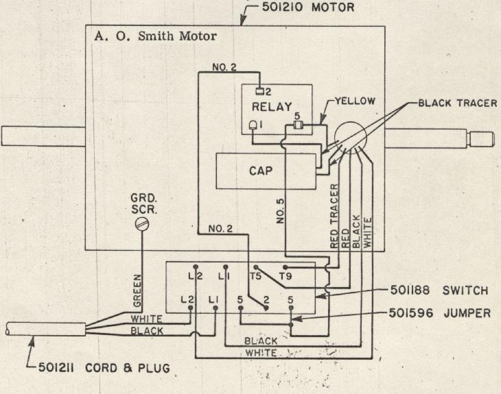

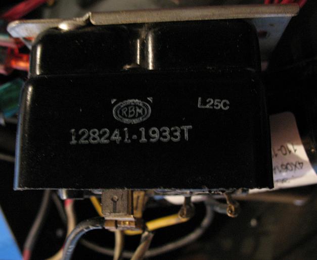

Thanks for the quick reply,
I've found the link below from the information you had given:
https://forum.shopsmith.com/viewtopic.php?t=3227
I'm trying to understand how the "black box" works.
Attached are (1) the wiring diagram from my Mark VII original documentation and (2) the markings on the "black box", and (3) my guess at the schematic for the "black box" - starting capacitor - motor.
Any ideas of how this might work?
[ATTACH]11329[/ATTACH]
[ATTACH]11330[/ATTACH]
[ATTACH]11331[/ATTACH]

ryansm7 wrote:Thanks for the quick reply,
Understand the switching action will help!
https://forum.shopsmith.com/viewtopic.php?p=29656&postcount=12
The L1/L2 terminals turn the motor on when either fwd or reverse.(wh/bk)
The T5/T9/5/2 terminals merely reverse the red/red-tracer wiring to the relay/cap/motor wires(notice the 'no2', 'no5' labeling of the relay wiring coming from the switch).
The 'no2' is connected to the start relay to one side of the current coil.
The 'no5' is connected to the start relay start winding connection(other end of coil) (yellow)
The start relay "1" terminal connected to the start cap is thus connected to either the red or the red tracer wires. That reversal of red , red tracer wire/cap polarity determines rotation direction.[the motor will run either direction if manually started][the coils are thus 'ambidextrous!]
Not sure your start relay schematic is accurate(S/R reversed????)
BTW it is an Inductive run, Capacitive start motor(I stand corrected-the start relay through me off-shoulda known better!!!)
JPG... you da man!!!
I'll check the connections on the Start/Run windings. If you are right about the capacitor polarity, I need to check the rotation direction on power-up.
I think the contacts of the relay should be normally closed at power-off (internal pins 1 to 2). I'll double check that also. Right now the diagram shows it normally open.
~Ryan
ryansm7 wrote:JPG... you da man!!!
The contact should be normally open. The high run current at startup flowing through the coil causes the contacts to make thus connecting the start capacitor. After it gets up to speed, the run current decreases and the contacts again open taking the start capacitor and start winding out of action.
Two things to keep in mind.
The RUN winding current energizes the coil.
The start capacitor is switched 'on' by the high run current at slow speed and is disconnected when the run current drops below a starting level.

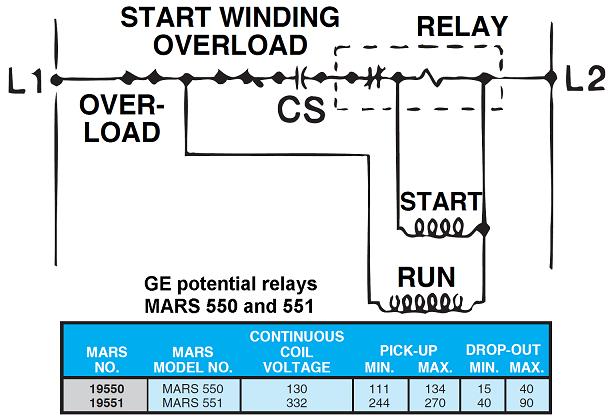

Thanks again JPG,
I haven't pulled the motor out yet to make measurements on the relay. I guess I'd better just replace it before I run into permanent problems.
Do you think the MARS 550 would be a suitable substitute?
See attached spec.
[ATTACH]11338[/ATTACH]
See attached spec.
- GE_Potential_Relay_Mars_550_551_3.JPG (42.77 KiB) Viewed 6682 times
~Ryan
Maybe! How about a pix of the motor name plate!!!!!!ryansm7 wrote:Thanks again JPG,
See attached spec.
Hi JPG,
I could not get a clear pic of the motor name plate without completely removing the motor. Here are the specs for the motor. The following is exactly stamped into the name plate.
MODEL C48L2A7
HP 1-1/8
RPM 3450
CY 60
PH 1
SF 1.0
VOLTS 115
AMPS 12.6
SF AMPS
CODE H
TYPE CS
SER 163
FR 48
RISE 50
CONT DUTY
All measurements were taken with a digital multi-meter.
POWER ON MEASUREMENTS:
Pins 1 to 5.... 122VAC
Pins 1 to 2.... 300VAC
Pins 5 to 2.... 266VAC
POWER OFF MEASUREMENTS:
Pins 1 to 5.... 0VAC
Pins 1 to 2.... 0VAC
Pins 5 to 2.... 0VAC
The relay was electrically disconnected from the motor and capacitor for these measurements.
Pins 1 to 5.... 3.2 Ohms
Pins 1 to 2.... 0.0 Ohms
Pins 5 to 2.... 3.2 Ohms
