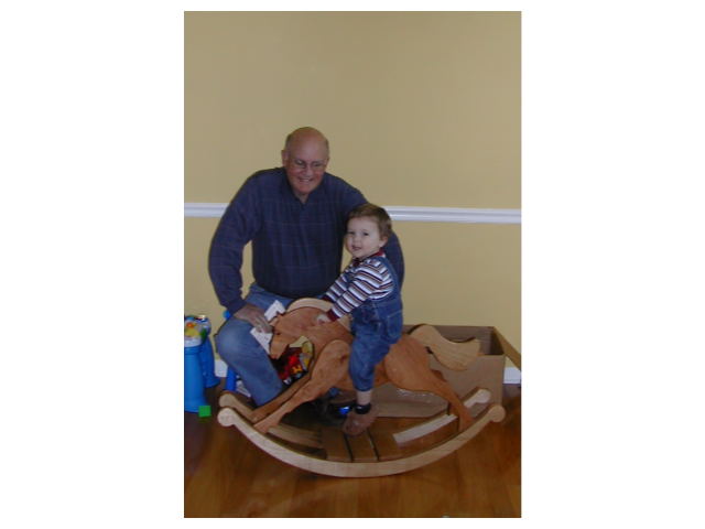

OK, I couldn't resist. Here are some pictures a rocking horse I made several years ago (I actually made two). They are from plans from Wood magazine.
To the issues:
Sanding smooth - I just finished a doll cradle with rockers. As has already been mentioned, I just sanded then to a line using the disk sander and then smoothed it all out on the bottom of the belt sander.
Grain direction - The rockers on the rocking horse in the picture are actually glued up from two 5/8" thick blanks. One of the blanks was two pieces glued together in sort of a "V" with the grain at an angle and the other blank was actually three pieces glued together with the grain parallel to floor. Three pieces were used to reduce the width needed to accommodate the arc.
I know this sounds complicated, but what it did was have each rocker constructed from blanks with dissimilar grain direction thus making the rockers much stronger. Some far, six grandchildren and ridden them hard and they've held up well.
I can't resist pointing out my mistake as well. You may notice the lighter dot on the rear leg. I carefully matched grain on the plugs covering screw heads, but somehow got a maple one in this spot instead of cherry.
