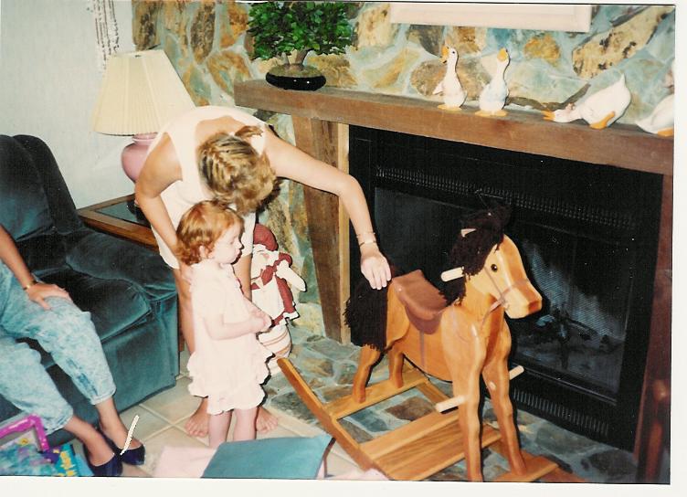

[ATTACH]656[/ATTACH]
Here is a picture of my daughter introducing my granddaughter who is now 20 to her new horse named Stripe. Stripe has been ridden by 6 garandchildren. Stripe has fared better than me through all these years. He was a plan found in Woodsmith, his mane and tail made from yarn and the saddle, bridle from leather and plastic eyes all came from the kit Woodsmith offered.
I was looking through some old pictures and came across this one, couldn't resist posting it.

Nice job on the horse! I hope you had as much fun building it as the kids have riding .
