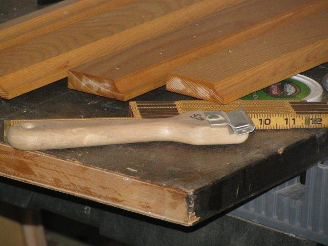

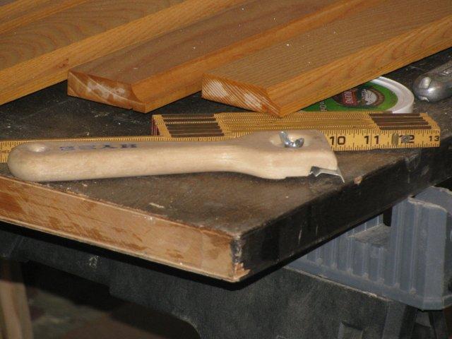

I've used the same method as you for removing the semi-congealed glue using a chisel. But, I'm sometimes a bit careless/klutzy with the chisel and found that this paint scraper works better for me and edge glue-ups.
[ATTACH]17292[/ATTACH]
[ATTACH]17293[/ATTACH]
Still have to be very careful with the corners on it as well.
- IMG_0760.jpg (45.56 KiB) Viewed 1903 times
- IMG_0761.jpg (45.77 KiB) Viewed 1902 times

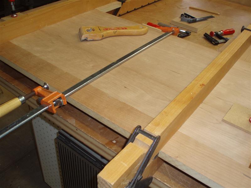

I even dug out an old paint scraper so hopefully I can sharpen the chisel and put it back where it belongs.
[ATTACH]17294[/ATTACH]
This is my last glue for the project that is currently in work. No glue has been applied yet. I don't expect the scraper will work quite that well.
- Edge Glue Up 001 (Custom).JPG (62.22 KiB) Viewed 1883 times

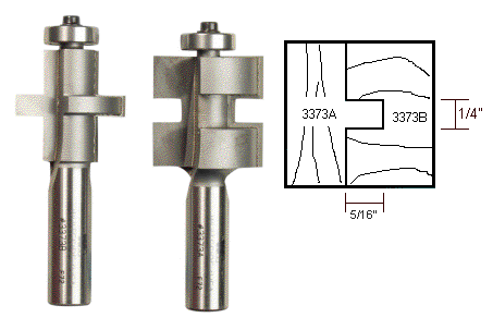

Being a little old fashioned I am fond of tongue & groove glue joints. I prefer a tapered T&G over a square cut one.
This is a straight cut T&G:
[ATTACH]17296[/ATTACH]
This is a tapered cut T&G:
[ATTACH]17295[/ATTACH]
I think that the tapered cut will start together better and will then always line up when clamped.
And of course always work with the veneer side against the table / router base etc.
Not saying that is the right way, just how I would approach it...
- temp tapered t&g cutter.jpg (8.97 KiB) Viewed 1882 times
- temp straight t&g cutters.gif (23.65 KiB) Viewed 1879 times
