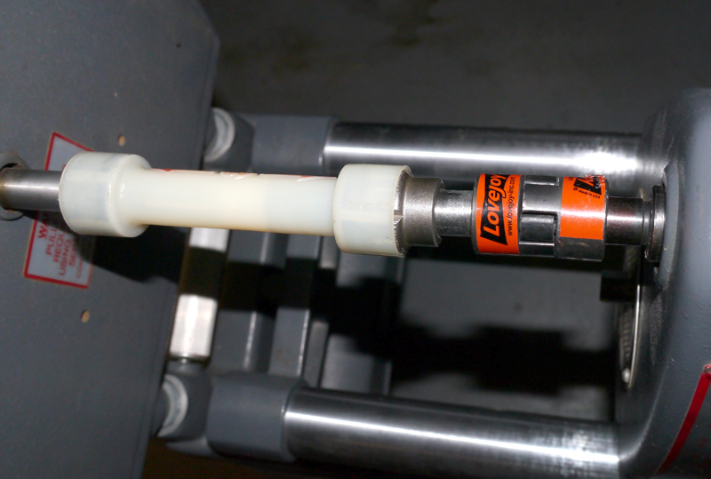

I don't know. It missed my bandsaw by about half an inch. I may see if turning the eccentric tubes on the bandsaw by 180 degrees would be a fix. Probably will. The photo with the coupler shows the headstock jammed tight against the carriage. You can probably get an idea how close the coupler was.terrydowning wrote:I have considered a table on the left like your 2nd and 3rd pics. Any idea if this will prevent the coupler from connecting to a Jointer??

Getting more table surface was definitely one thing I wanted (either side!). Now I gotta figure out which way works best. I'm still not convinced to go right vs left. Think it's going to be trial and error. Now I'm trying to decide how to lengthen the coupler an inch! I have an idea involving a 5/8" Lovejoy connector set and a 2" piece of a 5/8" diameter piece of steel rod.

That was my original thought, but I had been unable to locate the coupler. When I searched for it (Ebay, Grainger, etc.) I tried "coupler" and "shaft extender"....but Grainger's term is "coupling", so I missed it.
Here is my Lovejoy setup. I already had a Lovejoy, so I just cut a 5/8" bolt for the extension (5/8" O.D. x 2" long). Seems to work well. I like yours better (fewer pieces).
From R to L:
Headstock shaft with Lovejoy attached >5/8" bolt section>drive hub>coupler>accessory hub on bandsaw.
[ATTACH]17350[/ATTACH]
Thanks, Fred
