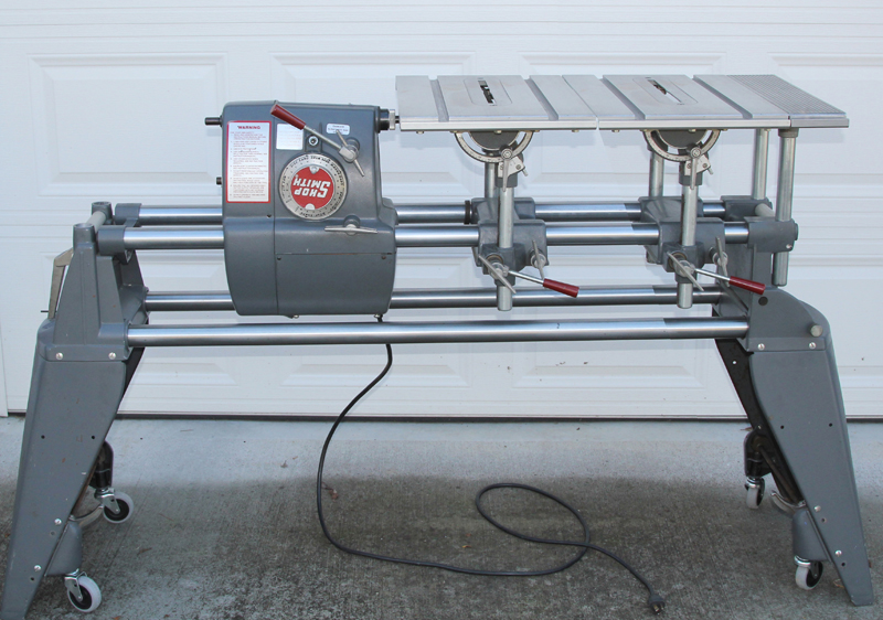

Here are some images of possible configurations:
2 tables to right of headstock;
[ATTACH]17345[/ATTACH]

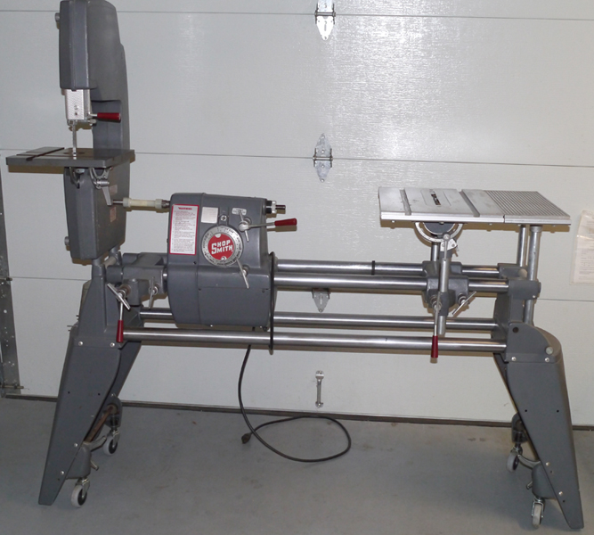

one table to right, but carrige of 2nd table still in place to left. Very close to coupler not being long enough. This is with offset tubes on bandsaw.Straight legs should be better:
[ATTACH]17346[/ATTACH]

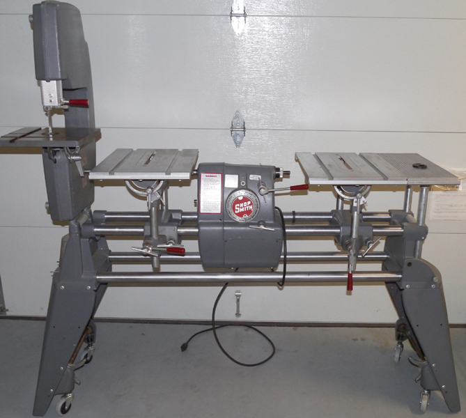

2 tables, one to each side of headstock:
[ATTACH]17347[/ATTACH]
Thoughts, anyone?
Thanks, Fred
Thoughts, anyone?
Thanks, Fred

Seems like the more useful scenario would be a carriage on either side. Using two on the right just seems like it would be the same as building some sort of larger extension on the right side of the SPT mount extension table.fgrule wrote:Here are some images of possible configurations:
2 tables to right of headstock]17345[/ATTACH]
Thoughts, anyone?
Thanks, Fred
Then again, if you were turning a long spindle, two carriages on the right side would allow you to set up a long custom tool rest...hmm

I have considered a table on the left like your 2nd and 3rd pics. Any idea if this will prevent the coupler from connecting to a Jointer??fgrule wrote:Here are some images of possible configurations:
one table to right, but carrige of 2nd table still in place to left. Very close to coupler not being long enough. This is with offset legs on bandsaw.Straight legs should be better:
Thoughts, anyone?
Thanks, Fred
Curious. Also would need to find old carriage and table.
