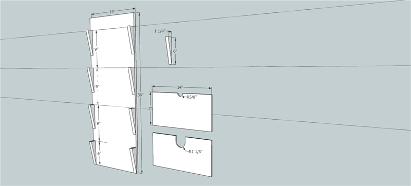

hjlssfor1 wrote:Dusty, could you please provide dimensions of the front plate and the wedges? I would like to replicate your rack.
Thanks, Hank
I will.
I had this one done for the sanding disks. I'll post it so that you can let me know if it answers your questions. If not, I'll do what I can to clear up the confusion. I violate a lot of engineering protocol when I do these but ....well hope it helps.
Word of caution: The conical disks are deeper than are the flat disks. For that reason, the front panel gets mounted a bit different to provide the required rear clearance.
[ATTACH]17418[/ATTACH]
Conical disks go with the upper front panel and flat sanding disks go with the lower front panel.
- Rack for Sanding Disks (Custom).png (52.53 KiB) Viewed 1143 times
dusty wrote:I will.
Protocol be damned! Looks quite effective to me!;)
Looking at yer pix, it appears the conical disk fronts are mounted 'higher'.

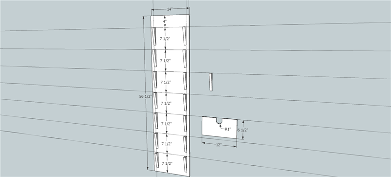

hjlssfor1 here is the one for Saw Blades with Arbors.
I hope these work for you. You can see how I am using them in the previous photos.
[ATTACH]17419[/ATTACH]
These items (blades with arbors and the sanding disks with arbors) are heavy. Make certain that your glue joints are good. A fall from the wall would do NO GOOD for your saw blades or the disks.
There is a missing dimension! The wedges are set in from the sides 1".
- Rack for Saw Blades with Arbors (Custom).png (71.02 KiB) Viewed 1145 times
And the wedges?dusty wrote:hjlssfor1 here is the one for Saw Blades with Arbors.
And 14" is what fits between yer port holes.
The windows are just a little bit further apart than 14" but yes, that is what dictated the width.JPG40504 wrote:And 14" is what fits between yer port holes.
