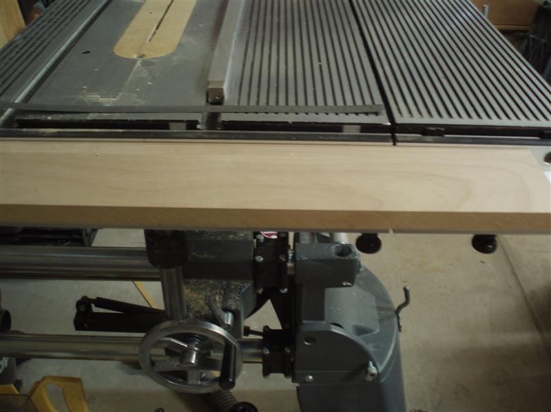

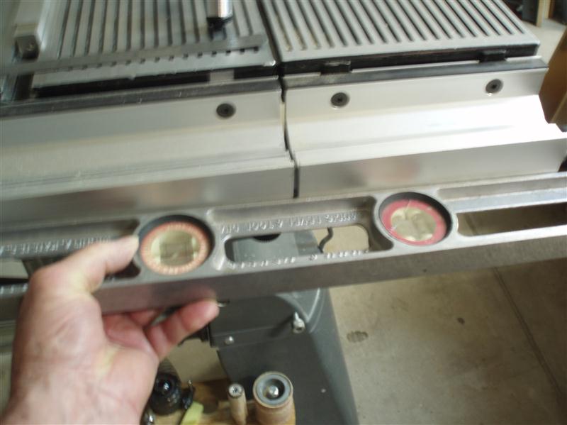

This theoretically can not be unless the face of the front rails on the floating and extension tables are not perpendicular to the miter slots. The rip fence orients itself to the front rail to which it is attached.
This orientation can be verified by placing a long straight edge on the front rails to verify they are in the correct plane (all the same plane).
[ATTACH]17809[/ATTACH]
[ATTACH]17810[/ATTACH]
Sorry for the fuzzy picture. I could not hold the camera steady while holding the level in place.
I've been told that my Stanley Level is not dependable as a straight edge and that I need an expensive straight edge for this task. Be that as it may. Use whatever straight edge you have that you trust and check the rails with respect to the rail on the main table.
If you don't have a straight edge, make like an Egyptian and use a string stretched taunt across the rails.:)
