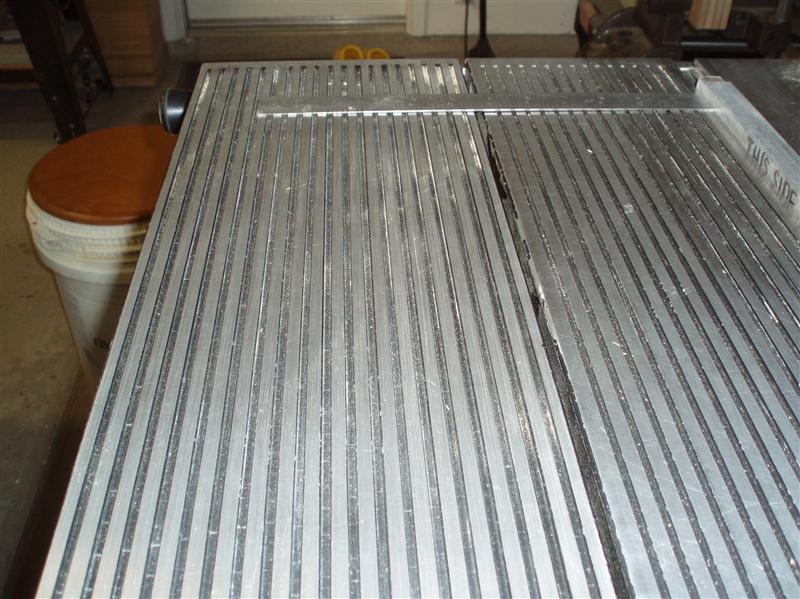

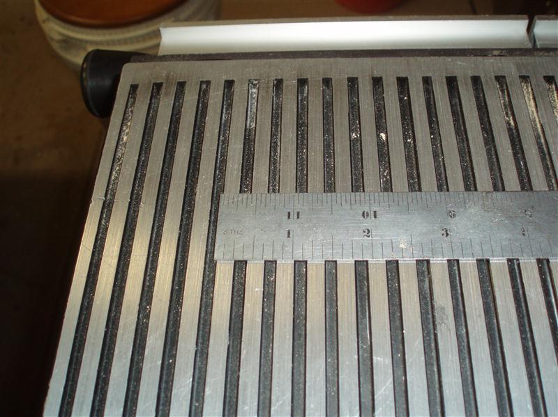

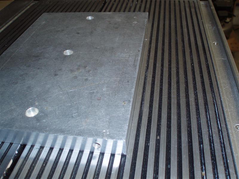

Now, this may a related problem to the one I originally described or a separate one. With the extension table mounted in the base arm, I am at a loss as to what could cause the rip fence to be so noticeably out of alignment to the grooves on the extension table when the fence is placed on the extension table only. I admit that the extension table may need to be adjusted to get the fence parallel to the blade/miter slots, but no matter how the extension table may be sitting on it's dog bone, the fence rails should still be parallel to the extension table edge and hence perpendicular to the grooves on the extension table and a fence mounted on these rails ought to be parallel to those grooves.
[ATTACH]17803[/ATTACH]
The tables are NOT quite touching. I tweaked them to emphasize alignment of the ribs in the next two images.
[ATTACH]17804[/ATTACH]
You just have to trust that the aluminum block is square.
[ATTACH]17805[/ATTACH]
- Extension Table Alignment 001 (Custom).JPG (86.3 KiB) Viewed 3317 times
- Extension Table Alignment 003 (Custom).JPG (82.66 KiB) Viewed 3303 times
- Extension Table Alignment 004 (Custom).JPG (93.46 KiB) Viewed 3309 times

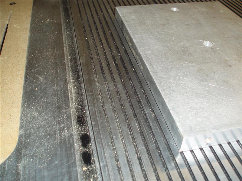

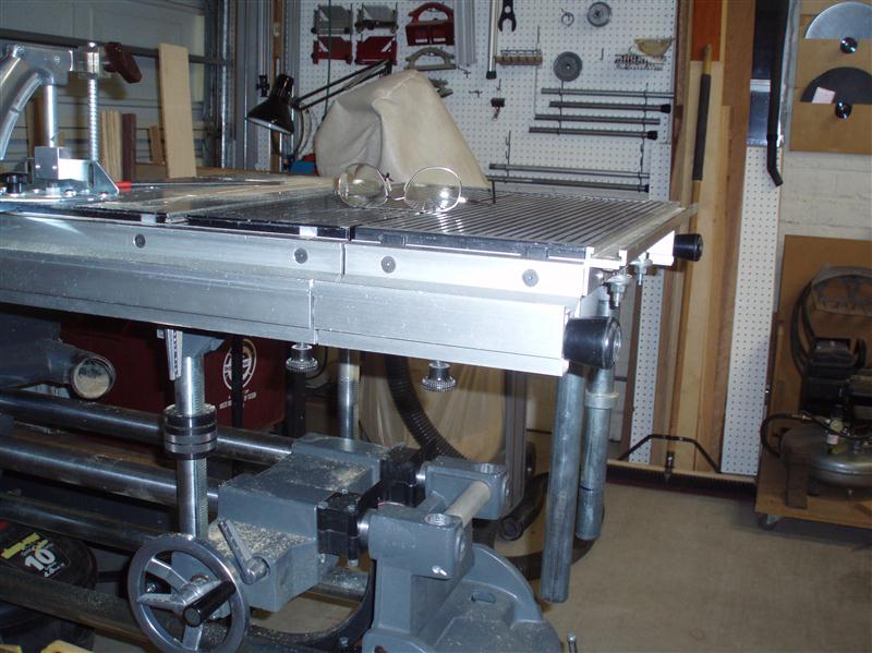

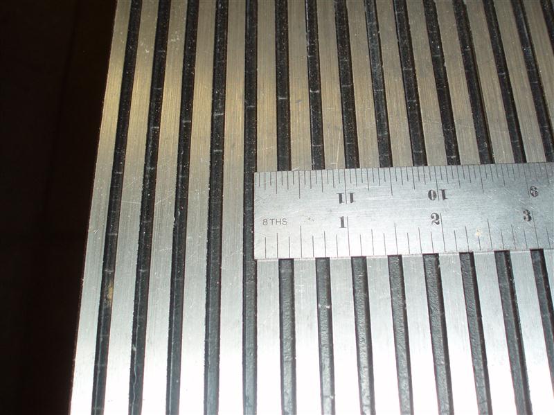

With the floating table tight against the main table, the ribs are parallel to within 1/32". If you need it dead on parallel, that can be done by tweaking before you lock the floating table to the extension tubes.
I rip fence mounted on this floating table should be equally square with the floating table as it is with the main table.
[ATTACH]17806[/ATTACH]
[ATTACH]17807[/ATTACH]
[ATTACH]17808[/ATTACH]
- Extension Table Alignment 016 (Custom).JPG (99.35 KiB) Viewed 3302 times
- Extension Table Alignment 014 (Custom).JPG (84.75 KiB) Viewed 3298 times
- Extension Table Alignment 012 (Custom).JPG (82.32 KiB) Viewed 3296 times
