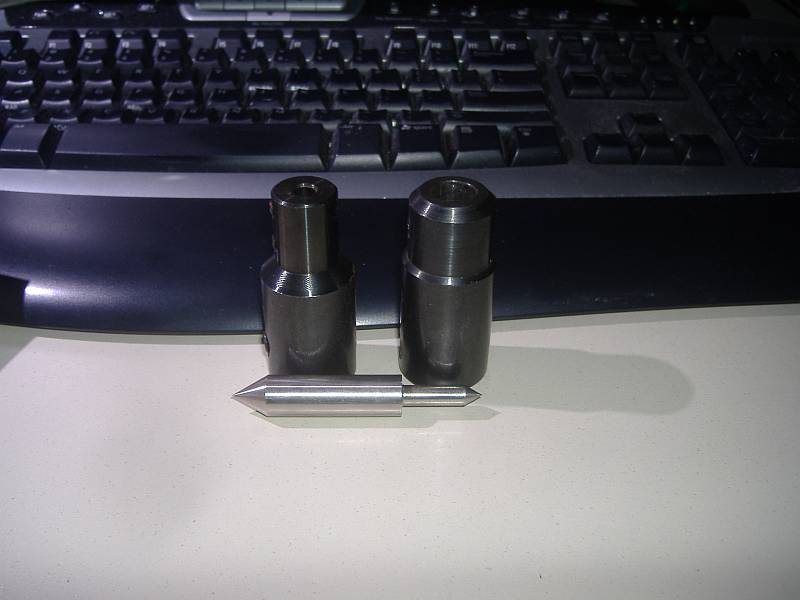

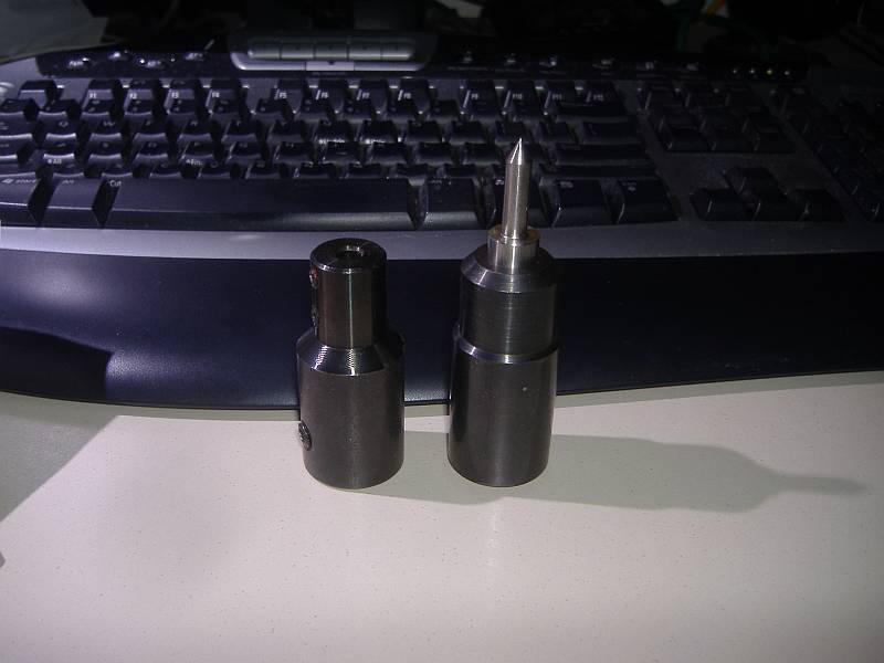

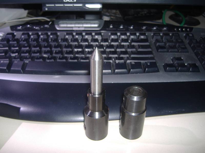

Hi,
Here is a picture that shows both the shopsmith 1/4" and 1/2" router chucks along with a centering tool. This was mentioned earlier but I figure a few pictures might not hurt.
I have one centering tool I keep with my drilling stuff and another I keep with my router stuff. They are very useful and worth buying even if you don't go with this for lathe turning.
[ATTACH]18051[/ATTACH]
[ATTACH]18052[/ATTACH]
[ATTACH]18053[/ATTACH]

- DSCF3488sc.jpg (53.28 KiB) Viewed 3565 times
- DSCF3489sc.jpg (60.84 KiB) Viewed 3564 times
- DSCF3491sc.jpg (52.69 KiB) Viewed 3564 times
