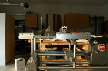

I have had a similar situation and can not get it resolved. In my situation it looks like the entire machine is racked but I can figure out where. The bench tubes are inserted into the casting up to the stop. I can align the extension table on the right but no way can I get to align on the left. The table wants to move forward (toward the operator) when installed on the left side. Also when I install the extension table in the left end of the machine there is a very noticeable downward tilt of the table in the direction of the headstock.
In the first pic you can see how the table moves forward to the operator when installed on the left end

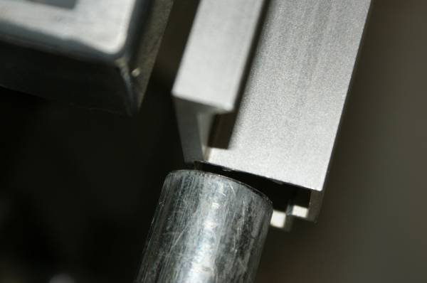

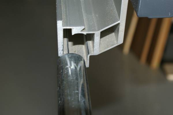

The second photo shows the rear rail of the extension of the table
[ATTACH]18224[/ATTACH]

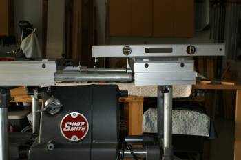

The third photo shows the definite downward (toward the headstock) tilt of the table and support tubes when the table is on the left end of the machine
[ATTACH]18225[/ATTACH]

Any suggestions?
The reason that I am posting this again is that my offset appears to be similar amount to Al's
Bill V
PS all pics are from the rear of the machine.

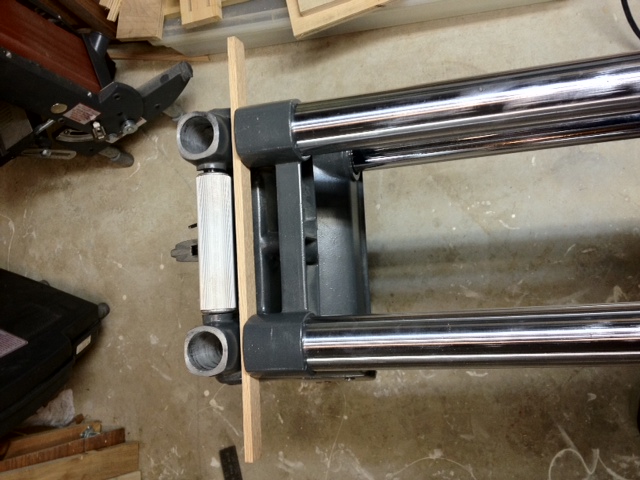

As discussed, I resquared the headrest using a spacer. What I had handy was a piece of oak that was a little over 0.25" thick; my calipers show it to be 0.28".
Here's a photo of the spacer in place.
[ATTACH]18233[/ATTACH]

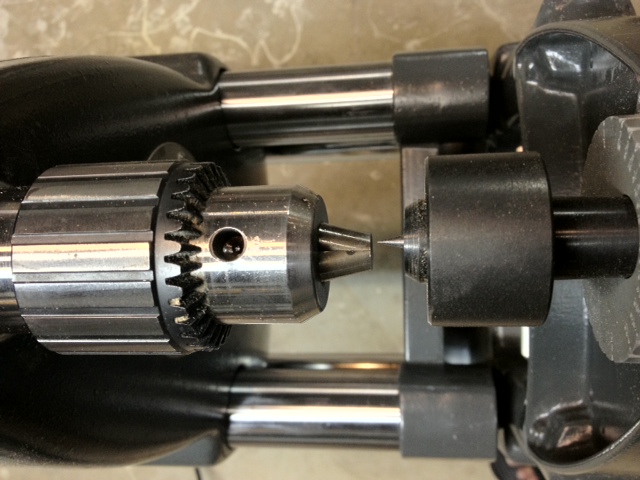

After squaring the headstock by pushing it up flush against the spacer (which is against the tie bar), I rechecked alignment with the drill chuck, lathe tailstock and live center. The improvement is small but definite. Whereas before the point of the live center missed the end of the drill chuck entirely, it now is pretty close to centered, as seen in the next photo:
[ATTACH]18234[/ATTACH]
I think I will probably declare victory on this issue.
Al
