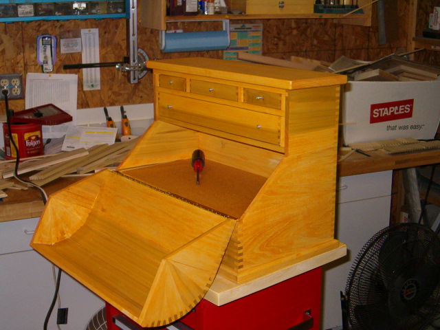

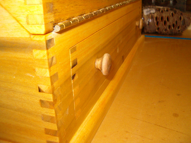

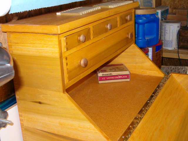

charlese wrote:Rather than bending, you can make slats with pie shaped sides then sand the curve. I did this technique on the small chest pictured.
[ATTACH]18344[/ATTACH]
[ATTACH]18345[/ATTACH]
This chest was made from 1/4" stock with box joints, but I'm pretty sure you can do a similar box from 3/4 stock. Glue up was no problem and you don't need box joints. Using solid stock rather than plywood should give a pretty substantial chest lid.
Sanding the wedges, with glued sides and top is a snap, because they are flat sanded. Rounding the curve is also pretty easy - just need to sand the mating edges after glued up.

swampgator wrote:Charles, that looks like a great idea and it appears to be very complicated. I guess the sanding is what does the trick and solid wood makes the sanding more acceptable. May go with solid wood. Thanks.
Also, that is beautiful craftmanship and a beautiful chest. Any inside pics?
Thanks! but really quite simple.
[ATTACH]18366[/ATTACH]
[ATTACH]18367[/ATTACH]
LOWER DRAWER FACE.
[ATTACH]18368[/ATTACH]
Smaller knobs.jpg (141.68 KiB) Viewed 3052 times
close-up knob.jpg (140.39 KiB) Viewed 3049 times
