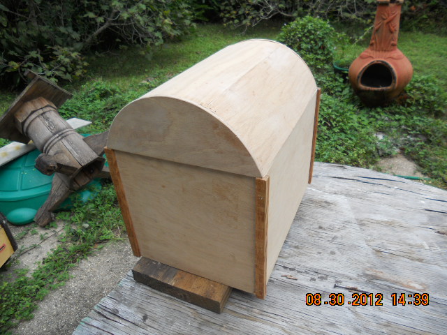

I need to make some pirate chests with bent plywood to make part of the lids. I have cut the 1/4" oak plywood with kerfs on the inside, but it still is resistant to bending. So, considering the idea of wrapping in wet bath towels and put in the cooking oven at 250 degrees for about 7 or 8 minutes. Has anyone tried this? Does it work well. Am I thinking hot enough or leaving it long enough? I am ready for any input.
I am hoping that I can attach one that I did just bending with clamps until I got it to work. Then because I cut it too short and had to put an extra piece in. Working and wishing I had done a better job. It can be replaced.
[ATTACH]18338[/ATTACH]
Edit A: OK, thanks to Bruce, I realize I did not make my questions clear. The pictured top is bent, but it was done with wrestling it like an alligator. I have two more to make like the one bent oak plywood above. Rather than wrestling for a very long time like the one pictured above, I just want to know if I can steam it in bath towels in a regular oven. Never done this before, so this is totally new territory for me. Have explored all the YouTube that I can find. Thanks for your help and input. I'll be very happy to hear of knowledge and experience.

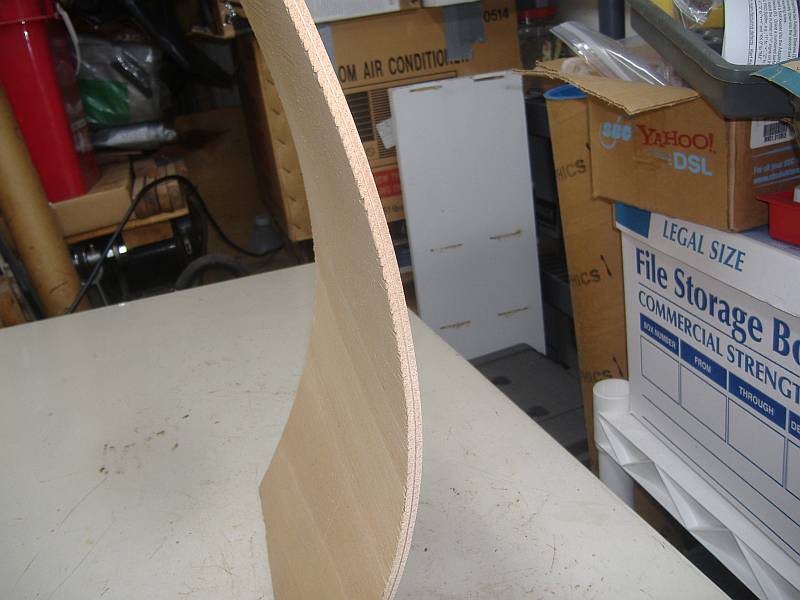

Some years ago I had a project where I needed flexible plywood and found that they make a bendable plywood. I don't recall who I got it from but it was just the thing for my project. Might have been either lowes or home depot????
It flexes in only with the outside grain directions.
I have a scrap left which I have pictured for you. I'm just flexing it by pushing on it from above. It does have it limits. Cost, don't recall either.
[ATTACH]18341[/ATTACH]

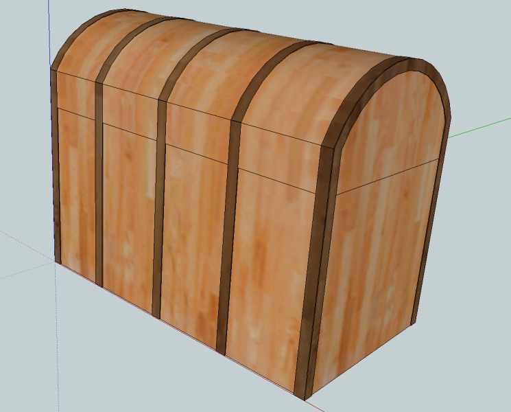

Actually what I meant was like the dark curved parts below.
[ATTACH]18343[/ATTACH]

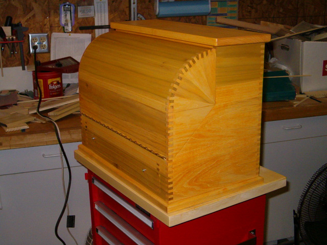

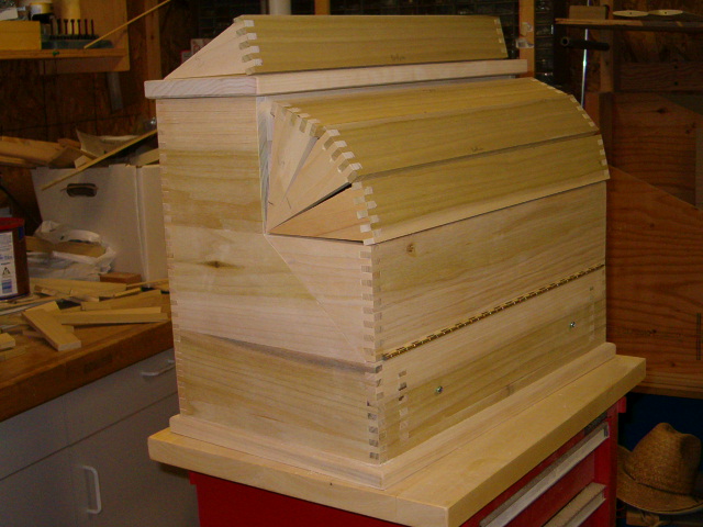

Rather than bending, you can make slats with pie shaped sides then sand the curve. I did this technique on the small chest pictured.
[ATTACH]18344[/ATTACH]
[ATTACH]18345[/ATTACH]
This chest was made from 1/4" stock with box joints, but I'm pretty sure you can do a similar box from 3/4 stock. Glue up was no problem and you don't need box joints. Using solid stock rather than plywood should give a pretty substantial chest lid.
Sanding the wedges, with glued sides and top is a snap, because they are flat sanded. Rounding the curve is also pretty easy - just need to sand the mating edges after glued up.

Charles, that looks like a great idea and it appears to be very complicated. I guess the sanding is what does the trick and solid wood makes the sanding more acceptable. May go with solid wood. Thanks.
Also, that is beautiful craftmanship and a beautiful chest. Any inside pics?

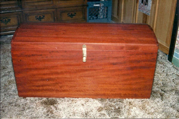

My Purple Heart Chest
Here's one I made for my daughter when I first got started with SS in the 80s. The top is curved and I did some of the same as Charlese minus the joinery. Remember it was one of my first projects but the top was not as difficult as I thought it would be. The photo doesn't show the curve much but is is.
