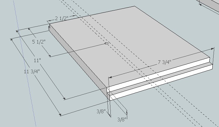

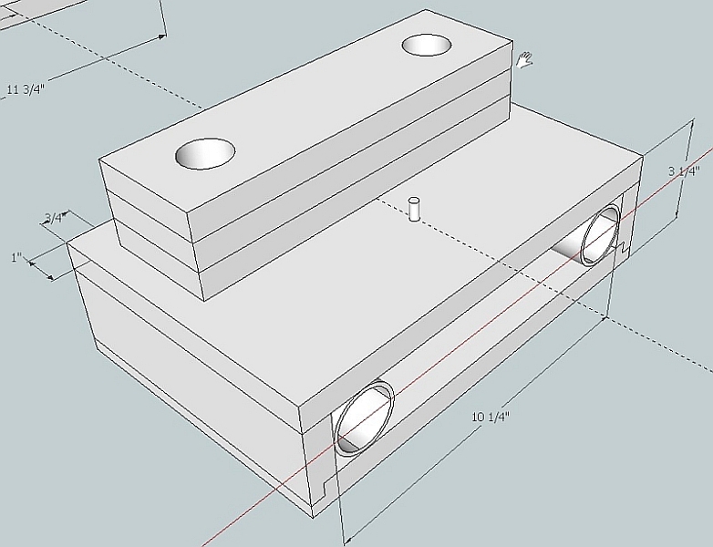

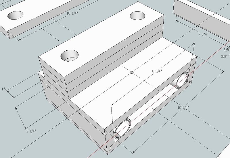

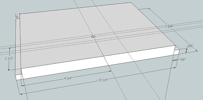

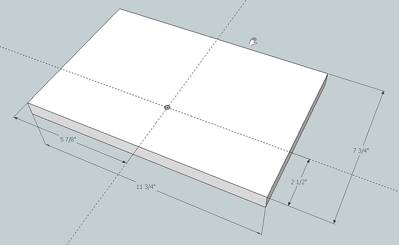

The top and bottom parts are identical for each version. They may be cut out that way and then bottoms selected for the addition of the rabbet.
Version 2 top and bottom
[ATTACH]18435[/ATTACH]
[ATTACH]18434[/ATTACH]
The holes sizes will have to be your selection based on what hardware you pick out. In my case the top is drilled 5/16 while the bottom is 27/64 to match the requirements of the threaded inserts I'm using. I am using 5/16-18 hardware.

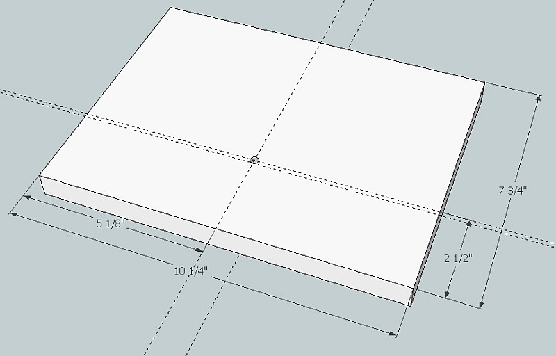

Version 3 top and bottom
[ATTACH]18436[/ATTACH]
[ATTACH]18437[/ATTACH]
Ditto on the hardware information above.
More to come

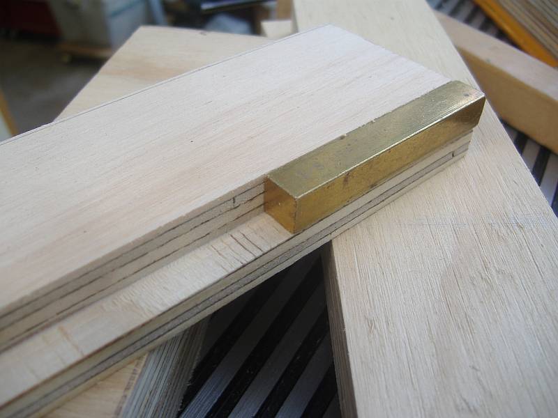

FYI on the rabbet joints purpose, it is there to make it easier to mount the bottom. If it were a butt joint it would be hard to keep it aligned when the bolt is dropped in and then would want to twist as you tightened it.
Besides it is a very fast joint to do in this case. One set up for all edges and you don't even have to worry about adjusting the width of the dado blade so long as it is wider then the 3/8" as the rest can be in the sacrificial fence.

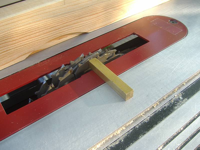

Since I was in the process of cutting up parts for an additional 4 of these I had the opportunity to shoot a few pictures while I was setting up for the rabbets.
This is only a few images and not intended to be all that much detail, just primer that goes along with how easy it is to set up to do rabbets.
In this image you can see the sacrificial fence, it is attached to the rip fence. You can also see the material that has been removed by previous use. So long as that removed area is deeper and wider then the current project you can just slide the fence in place. If you need to go deeper and wider then you have to lower the sacrificial fence into the blade so a new cut can be made.
I'd also like to point out how the stacked dado is not set to make a 3/8" cut, no need to as the width of the cut is determined by the position of the fence.
Here I'm using a brass bar to get close to the height and width. Make sure you have the machine unplugged if you are working this close to the blade without a cover.

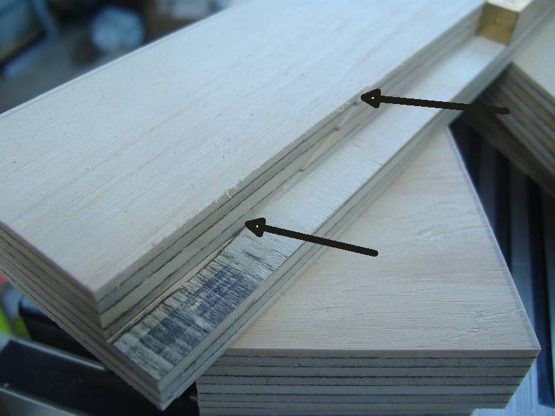

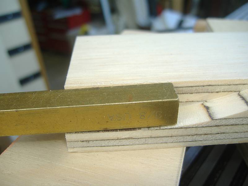

I like to use some scrap wood and make a test cut. In this case it is easy to see I'm off in both depth and width.
[ATTACH]18449[/ATTACH]
I then go back and tweak things. One time is the charm.
[ATTACH]18450[/ATTACH]
In this shot you can see how much the tweak was. Not all that much but well worth the couple of seconds it took to do.
[ATTACH]18451[/ATTACH]
Once set up it doesn't take long to do the rabbets.

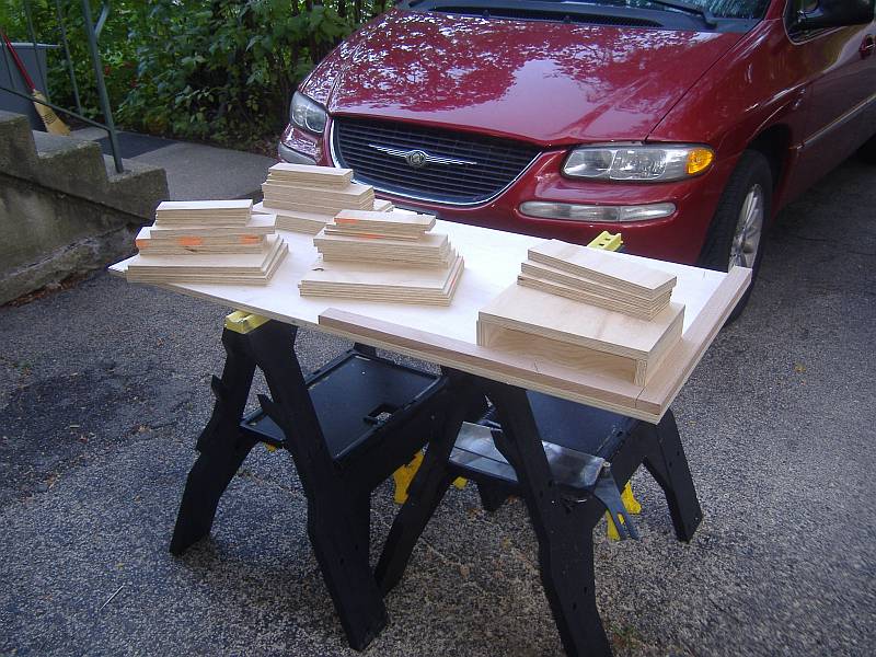

My original plan for the day was to make two, well getting a late start and searching out more scrap wood meant I was only able to cut up the parts for 4. Assembly and drill will have to wait for another day.
[ATTACH]18452[/ATTACH]
[ATTACH]18448[/ATTACH]
