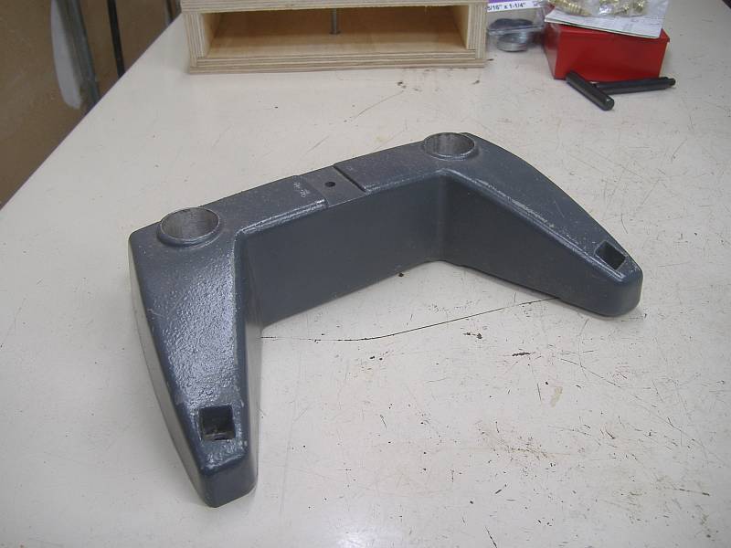

I have a shopsmith mounting base but at $45 each plus postage I don't think I'll get anymore of them just now. I also don't need a lot of the functionality provided by this item. For reference this is the item I'm referring to:
[ATTACH]18416[/ATTACH]

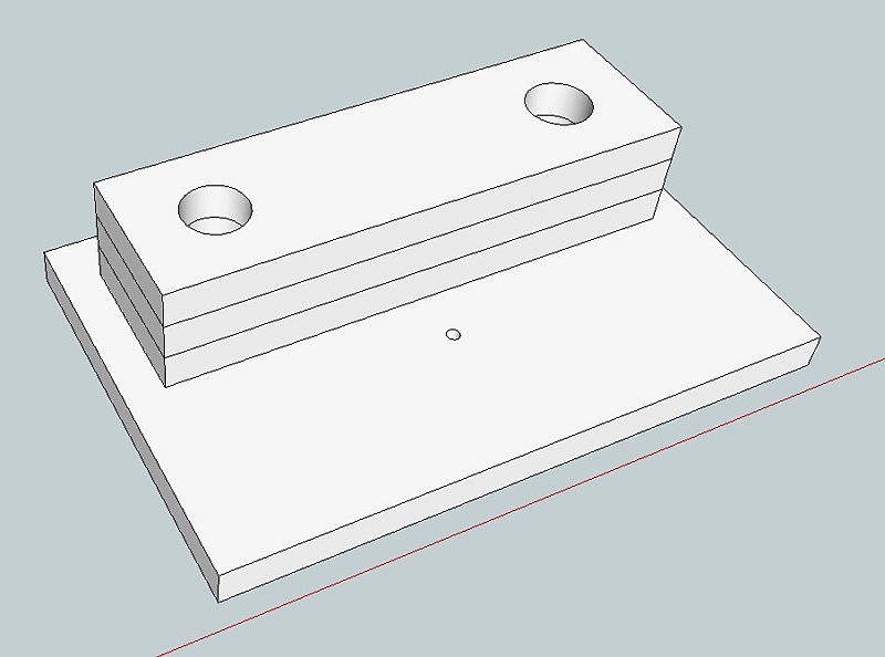

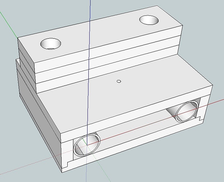

I used sketch-up to design the parts for the 3 versions I need. Version 1 is the simplest one and is designed to screw to a bench or shelf.
[ATTACH]18417[/ATTACH]

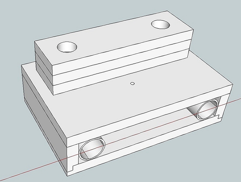

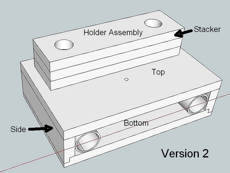

Version 2 has the addition of being mountable on the bench tubes, this is the version I will build several off.
[ATTACH]18418[/ATTACH]

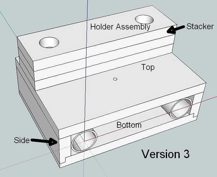

Version 3 is more than likely a one of that mounts to the way tubes. I'll see how it works and how much in the way it might get.
[ATTACH]18419[/ATTACH]
In the case of the tube mounted ones I will have a single 5/16 - 18 bolt holding it all together. It should be easy enough take on and off as needed. And they should also be able to stand on their own of the floor if need be.

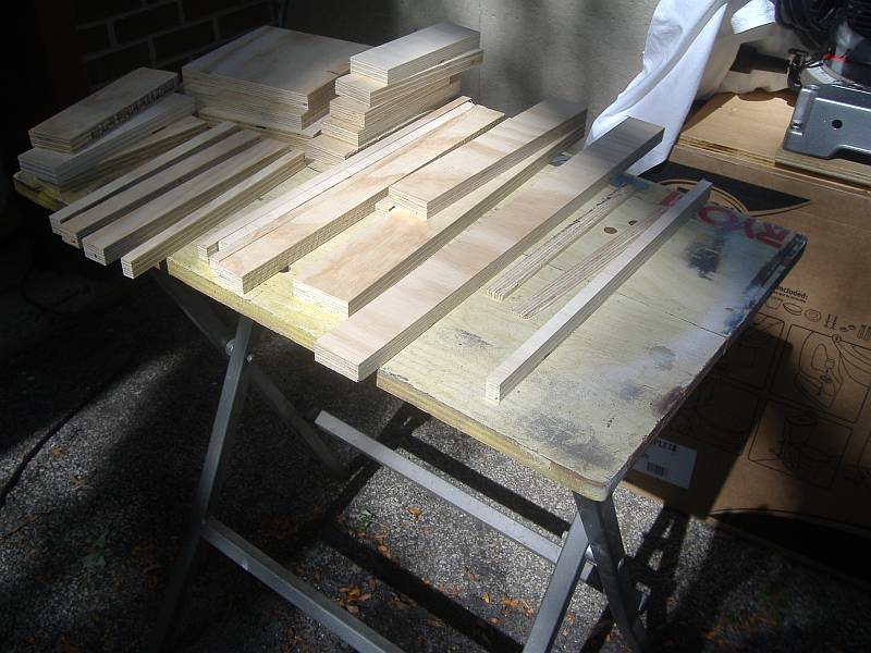

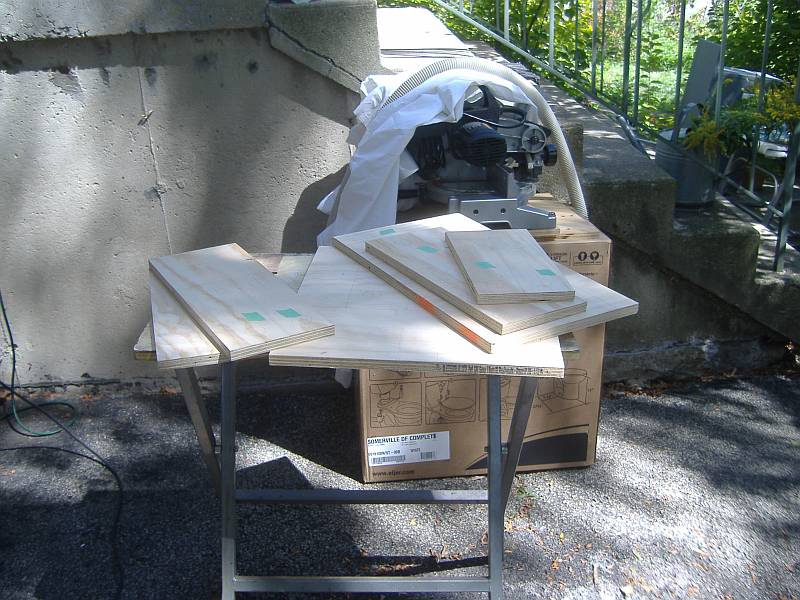

Then find some scraps of plywood. From the easy to get pile I had enough for a version 2 and 3.
[ATTACH]18421[/ATTACH]

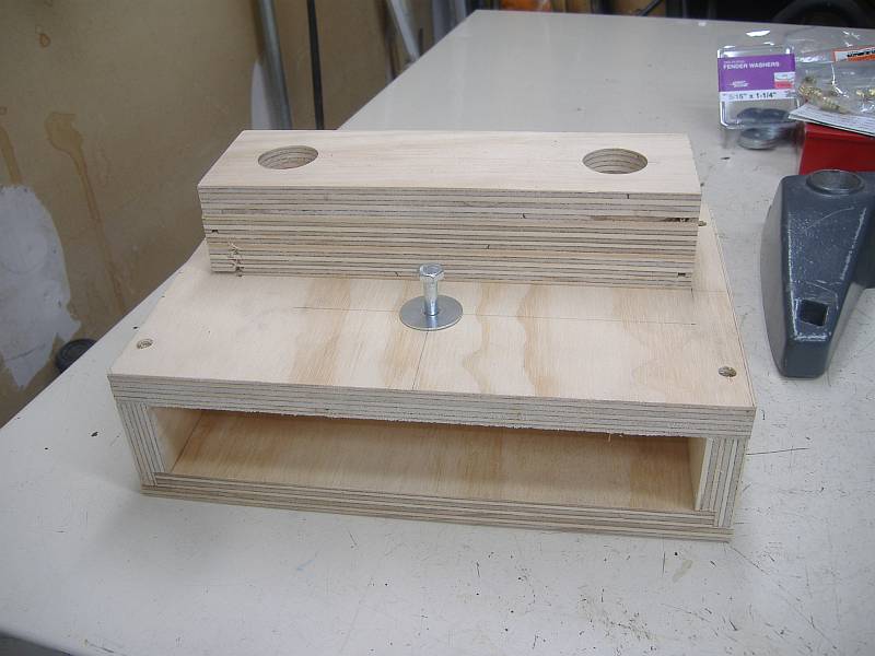

The good news was that I was able to make up the prototypes before it all became scrap or sawdust.
[ATTACH]18423[/ATTACH]
After examining the bolt I've decide to order a few snap-lock knobs so it will be even easier to assemble or disassemble these.

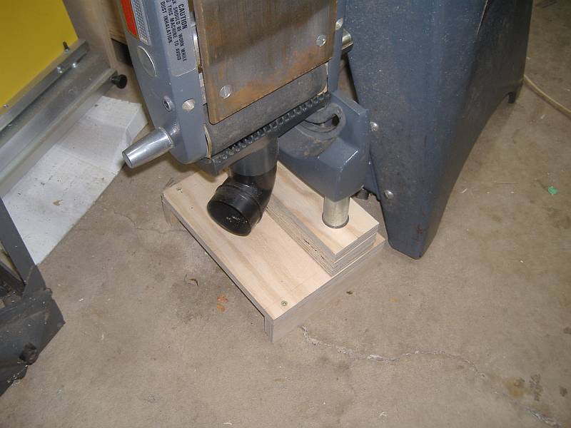

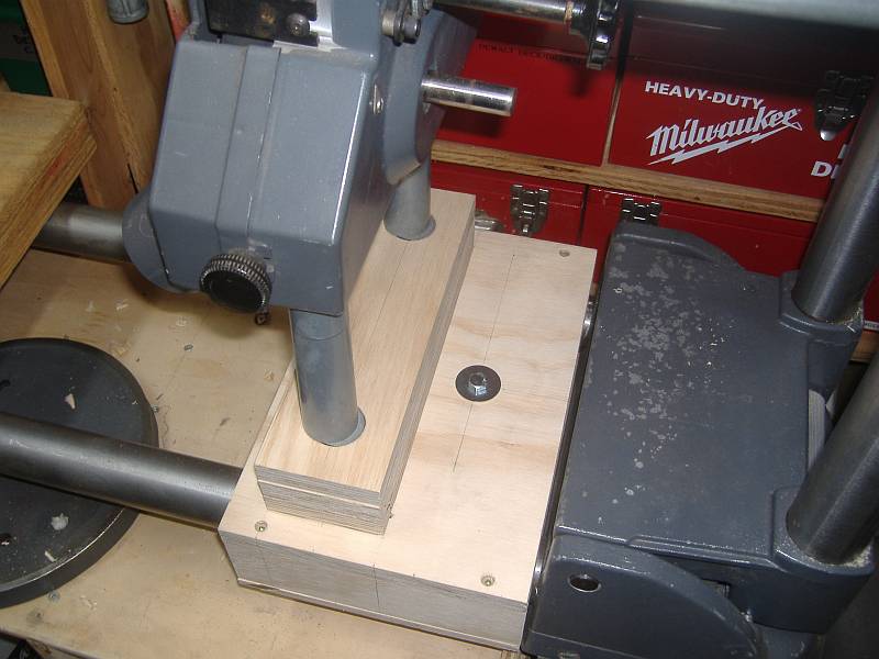

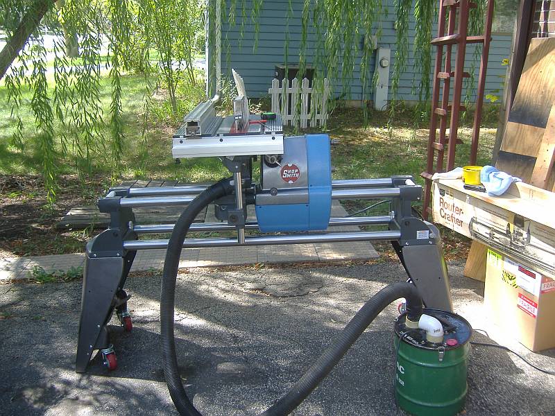

Here are a few pictures of the two versions I built. First a version 2 located on the "drill press" shopsmith.
[ATTACH]18424[/ATTACH]
[ATTACH]18425[/ATTACH]
This is the version 3 with a beltsander just sitting on the floor feeling pretty stable.
[ATTACH]18426[/ATTACH]

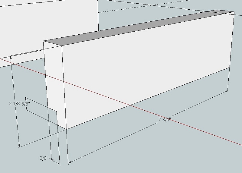

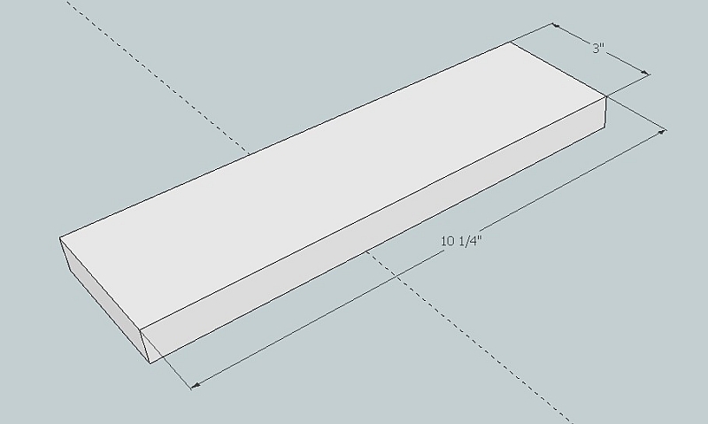

The following drawings should allow you to either make what you have seen in this post or to explore other options that might fit your needs better.
I've broken the drawings in to part drawings then a couple of assembly drawings. Some parts will work for both version 2 and 3, I will note that as I make the posting. To make it as easy as I can this is call out should make things pretty clear.
[ATTACH]18428[/ATTACH]
[ATTACH]18429[/ATTACH]

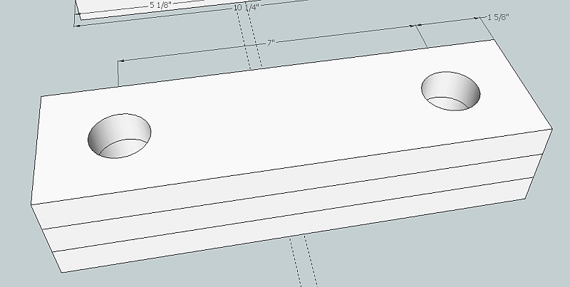

The common parts are the stackers and sides.
Three stackers make one holder, each storage unit has one holder.
(Note: Material 3/4" plywood scraps)
[ATTACH]18431[/ATTACH]
The stackers are assembled before you drill the holes. The tubes are 1-1/4" Dia. but since you will want a bit of slack to slide them in and out easily the 1-1/4" might be too tight. I went with 1-5/16" and that seems about right, you can of course experiment to determine what you like. If you decide to go smaller make sure you get the hole to hole distance right.
[ATTACH]18432[/ATTACH]
The sides maybe batch cut as they are all the same.
[ATTACH]18433[/ATTACH]
