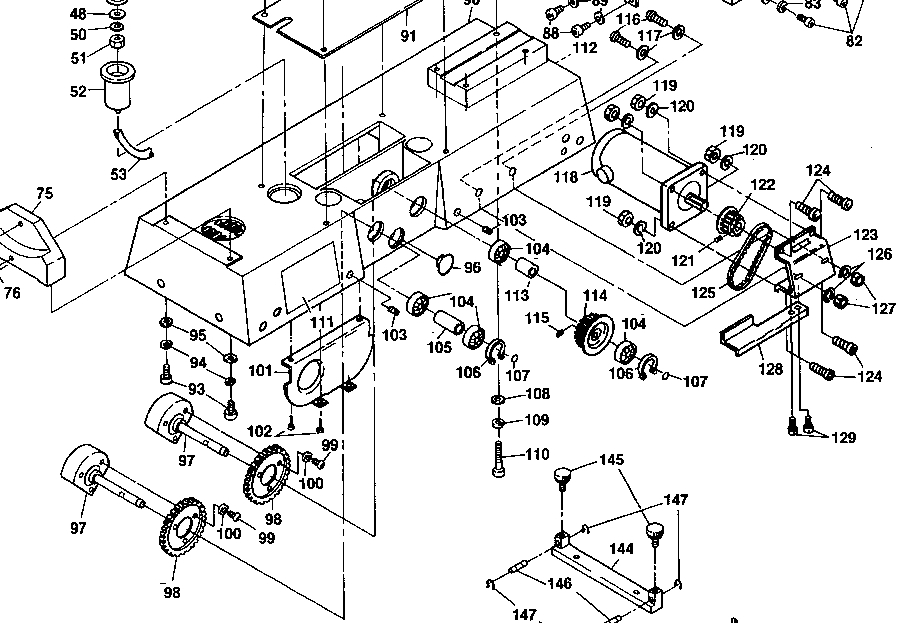

[attach]25466[/attach]
The numbers are different, but should be sufficient with the saw in view.

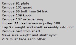

[attach]25467[/attach]
Maybe!;)

PTS refers to the points of the counterweights.beatnik wrote:Maybe PT's means pulley teeth ? So the ridge on the pulleys are on opposite sides to keep the belt from falling off ? Maybe I'm seeing it totally wrong.
I see the pulleys that way.
I am confused however. Did the belt change to an o-ring from what appears to be a cogged belt?
