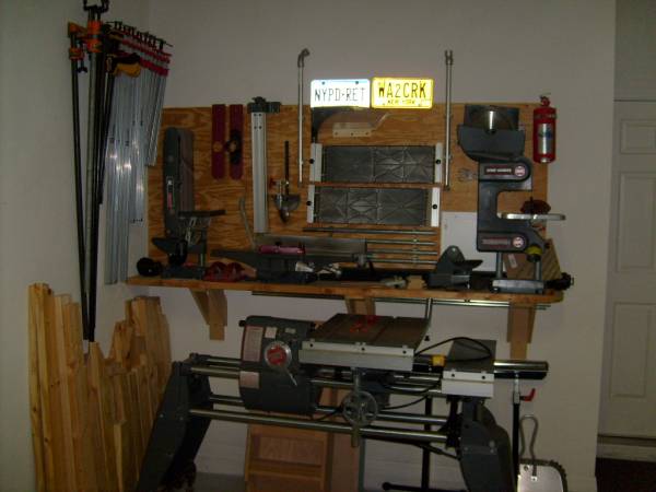

#1 I designed this setup some years ago. The table extension tubes are attached to the wall using metal broom handle clips available at most Ace HD or Lowes.

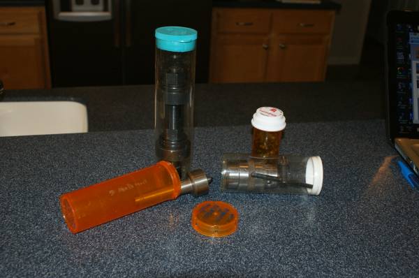

#2 is for small parts such as the drill chuck and the lathe drive centers etc. The pill bottles are virtually hermetically sealed and I have never had anything rust in them.

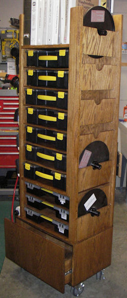

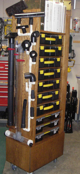

This is my version of storage for the many Shopsmith parts I find handy. The first time this was posted one member was a bit critical of it being 6 1/2 feet tall, skinny and seeming top heavy. Please note the bottom drawer is deep and holds heavy ballast like items. On one side resides my vac and dust collector tree. This is virtually the only way I have ever found to store them. On the other side my extra saw blades and sanding disks reside. Yes it is on wheels which allow movement all over the shop with ease. Yes it is highly stable. Jim

Hi Bill, Nice system. I think this would work for my shop. Any information on the support brackets? It appears some dimension lumber with plywood angle brackets? Right now I roll my jointer on a Harbor Freight cart. I had not figured out what to do with the bandsaw. Great idea.

The shelf for the SPT's is made from 2X6 lumber planed and edge jointed and glued together. The shelf brackets are made from left over MDF fastened together as an "L" and 45 deg supports.
The floating tables are held with large hooks that pass between the table and the extruded rails. When I used this system when my SS was 510 the sliding tables could be held with the same broom handle clips that hold the tubes. Just make sure that the plywood is held securely to the studs so it does not flex. That would cause the shelves to pop off the plywood.:eek:
I use the SS mounting feet to hold the SPT's but a 2X4 drilled with the appropriate sized holes and screwed to the main shalf would work just as well.
