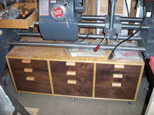

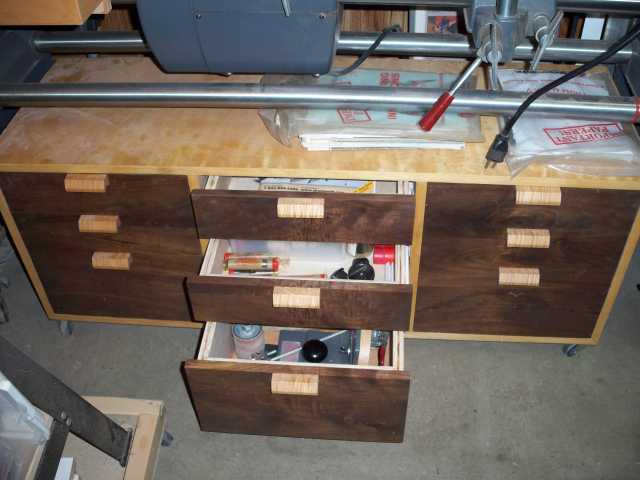

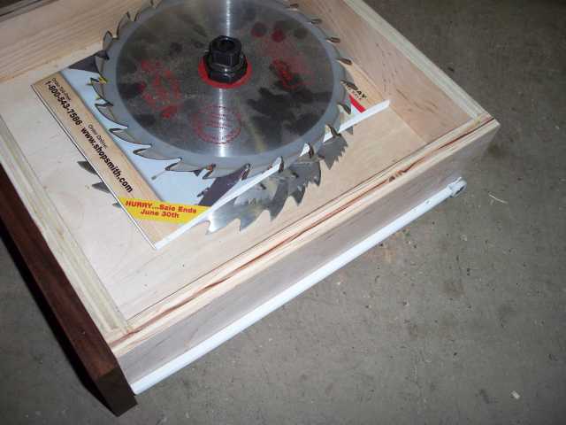

Here are a couple of photos of my storage cabinet. I used 3/4" birch plywood, with solid walnut drawer fronts, and 1/4" birch plywood for the back panel and drawer bottoms. I don't have any drawings for it, but it measures 48" wide, by 15 3/4" deep, by 17 5/8" high. With the two dividers, each section or opening is 15" wide by 16 1/8" high. The drawer fronts are 4" x 14 15/16", six of this size, and 8" x 14 15/16", three of these, and they were attached to the drawer boxes with a couple of screws. The small drawer boxes are 14" wide by 14 1/2" deep by 3 1/4" high, the deeper drawers are similar except they are 7 1/4" high, and the drawer slides are Blum 14". There are six 2" swivel casters from Harbor Freight.
It's a relatively tight fit between the Shopsmith legs, but that hasn't proved to be a problem.
