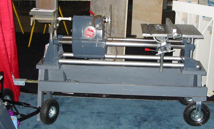

I made the following "Construction Shopsmith" from a Shopsmith that fell off the back of a pickup truck 7 years ago. The legs were torn off and had a lots of scuff marks. I had to sand and repaint it. I used a 2KW Honda generator on the extension table for power for the Shopsmith and all my power tools while adding a 1000 sq. ft. addition to our home. I can move it with my Kobota tractor and the hand mover. It has 10" tires and was very stable with any SPT mounted. I stored my power and hand tools on each side each night and parked the Shopsmith inside a shed for security. I have loaned it out several times as it loads very well on a tilt trailer.dusty wrote:Even though I am no longer moving around the world with my Shopsmith, I have given thought to putting it on a base that would allow me to eliminate the legs and set the nominal table height to where I really want it (lower because I am a shorty).
The single factor that keeps me from doing this is concern for the center of gravity. That concern would be even greater for a unit on wheels.
Other that this one thing, I think your idea would be a great solution for the traveling Shopsmith user. Oh yeah, build it stout. Simple glued dado joints are probably not adequate. Don't get carried away though, one day you are going to want to move this tank.
It is the same width as the Shopsmith legs and could be constructed either higher or lower as needed by the owner. I used bolts, lag bolts and deck screws (no nails) to assembly it. I was amazed at it's stability on the 10" rubber tires and had no problem towing or using it with any of the SPTs mounted. It was a cut and fit construction with no measurements being made. I still have it without a headstock if anyone is interested as I no longer use it.
[ATTACH]6760[/ATTACH]

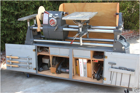

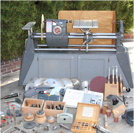

I meant to show you one from eBay that was for sale. It had a wonderful cabinet underneath the way tubes. It was hanging from the top bolt holes on the legs. There were three doors and one section had a place for each bit, another drawer for router bits and a special place for all his blades. All the other stuff was on one of the shelves in the cabinet. But, apparently, today, it sold. You may wish to visit Craig's List and ebay searching for Shopsmith's and you may find good pics to give you some ideas.
Have a super week and I hope to see pics of your dream under shop storage system.

I suspect that I saw the one you mean. I saved a couple of the pictures.swampgator wrote:I meant to show you one from eBay that was for sale. It had a wonderful cabinet underneath the way tubes. It was hanging from the top bolt holes on the legs. There were three doors and one section had a place for each bit, another drawer for router bits and a special place for all his blades. All the other stuff was on one of the shelves in the cabinet. But, apparently, today, it sold. You may wish to visit Craig's List and ebay searching for Shopsmith's and you may find good pics to give you some ideas.
hopefully, I'm not breaking too many rules by posting them.
[ATTACH]6775[/ATTACH]
[ATTACH]6776[/ATTACH]
