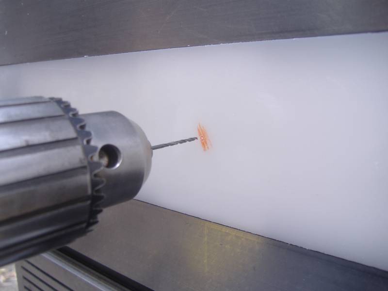

The process I used to locate the hole was to fit the insert in the table and then use a 1/16" drill bit to drill a through hole. I started by drawing a center line on the insert and using that for the starting of the process. I was set up in the motor below router position shown here when I drilled the hole.

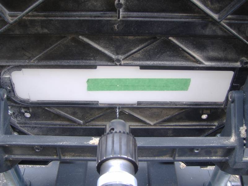

I then rotated the table to the router above (drill press) position. When I compared he hole position with the location of the bit it was actually about lined up with the edge of the hole. This could have been more like 1/32" difference, far closer then I ever expected.
[ATTACH]19256[/ATTACH]
By this time the slots had been done so there was no going back. I loosened the screws and move the insert to align with the bit and tighten in place to start the drilling process. A slightly over-sized hole would have worked in this case so long as it would hold the insert in place.
This is very interesting and I think impressive. It leads me to conclude that the main drive line is located precisely on the centerline between the main table uprights. One could also conclude that there is no slop in your drill chuck. There also can be no slop in the carriage when locked in position.
Like I said, I am impressed.
Just wondering, Ed. Did you enlarge the mounting holes in your trunnions. My guess is that you did not. For those of us that did, achieving this degree of alignment would be a bit more difficult.
HOWEVER, it seems like you could loosen the trunnions bolts and reposition the table such that it would align perfectly in both configurations.
